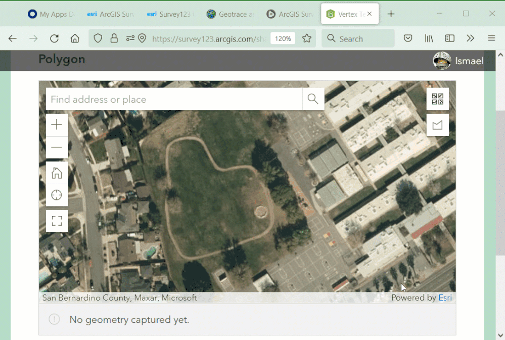

The following animation shows the use of the Survey123 vertex editing tools in a web browser:
Vertex editing tools in Survey123 web appVertex editing tools in Survey123 web app
To enable vertex editing:
  • In Survey123 Connect: For your geoshape or geotrace questions, set the value of the body::esri:style XLSForm column to method=vertex. More info in this help topic.

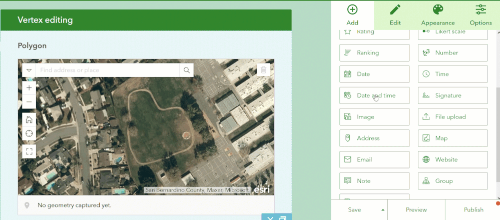

  • In Survey123 Designer: Enable the vertex editing tools as shown in animation below.
Enabling vertex editing in Survey123 web designerEnabling vertex editing in Survey123 web designer
