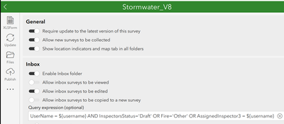

When you say delete, do you mean remove them from the end-users inbox? OR Delete the record? First check your Query expression to see if you can tweak something to remove the trigger that's keeping the records in the inbox.

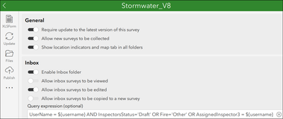

WE don't want users to delete records in the inbox because it would delete the record from AGOL.
What you can do is hide records from the inbox by using code to specify what you want the end user to see in the inbox.
Checkout this training at about 8 minutes Survey123 Padawan Academy WEEK 17 - Inbox Query Expression (youtube.com)
