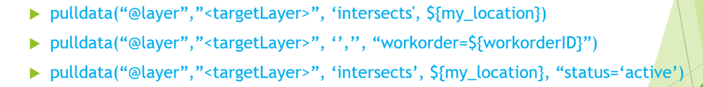

Would  syntax like this work for you?
The pulldata() function would return one record, from which you could extract the geopoint value.
By the way, when you say (without JSON), you really mean (without JS). Correct?

Thanks @Anneka_France  I added some additional details above, but do not take them literally. I think the requirement is well understood. Flagged as under consideration for now.
