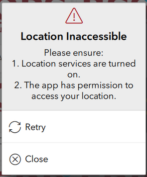

This one is just annoying. We have many forms that really don't care where the user is. However, all surveys in S123 require location services, and give you this annoying popup when the location sharing permissions aren't set:
Would be great if there was a toggle within Connect that could be enabled to just "ignore" location settings on a survey-by-survey basis. Just have the survey default to 0,0 (which it already does) and don't warn the user that their location services are off.

This is annoying every time, but I was running into issues where with our virtual desktop systems, it continuously tried to refresh the location thinking it had access, then failing to get a location, and returning an endless amount of this error message making the app unusable. Our solution ended up being turn off location as a whole at the Windows level.
From that incident I have an open enhancement with Esri: ENH-000162130 - Add an option for users to disable the Survey123 alert message pop-up 'Location Inaccessible'.

I know this is an old post but am encountering a similar issue. Discovered if you add a blank nmea file as the location provider and turn off alerts it prevents the popup appearing. It does feel very hacky though, can anyone envisage any issues as a result of doing this?
