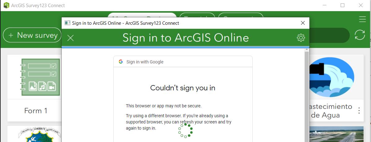

When attempting to login into Survey123 Connect using a linked Gmail account, you may get the following error:
This issue is under investigation at the moment. While a resolution is provided, you can workaround the problem as follows:

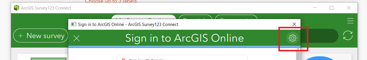

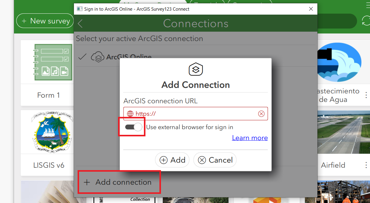

  • Click on the gear icon in the top-right corner of the Sign in to ArcGIS Online dialog.
  • Click on Add Connection and switch on the option "Use external web browser for sign in".

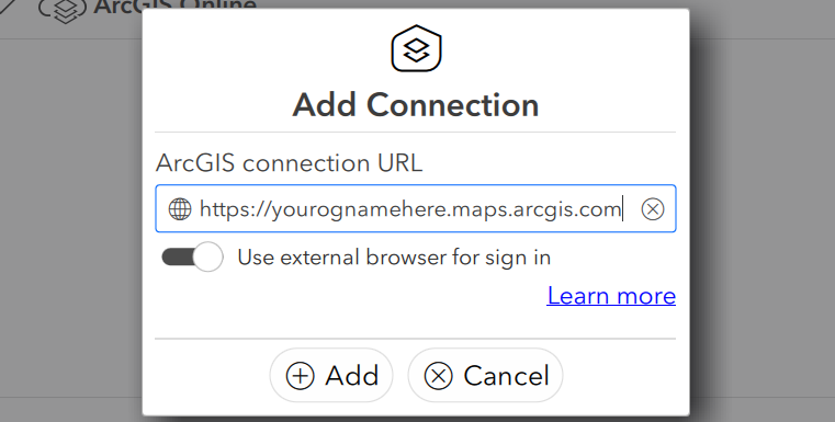

  • Once logged in, copy the URL of your organization as highlighted in the next screenshot. For example: https://yourorgname.maps.arcgis.com  Do not include the /home/index.html portion of the URL.
  • Back in Survey123 Connect, paste the URL of your organization in the dialog as shown below
  • Make sure the "Use external browser for sign in option is active" and then click Add.
