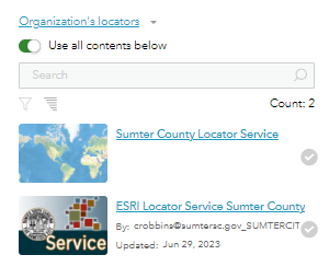

CharlesRobbins1
The Configuration of the Locators is the part I can not get to work correctly.
We have two locators configured in our Organization.  They both are listed in the Address Locator configuration of the question, but it will only use the ESRI View Locator and not our default one.  I can not uncheck or only select one locator.
Here is the screen capture of the "Choose Locator"
The top is working in the Map Viewer but not here.
