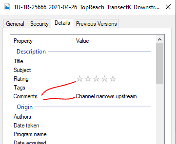

@IsmaelChivite Can we write TO the exif info?  I think I saw this posted but I can't find it.
I want to write my comments field into the Exif XPComment field.
Like this
I wrote some code to do it in Python which required some libs.
Would be really cool to add info to the exif right there in the form.
thanks

@IsmaelChivite I have the same question as Doug. Can we write TO the exif info? I am interested in using Survey123 for a web based citizen science project where users can add tags to the photos using the ImageXPKeywords exif.
DougBrowning
MVP Esteemed Contributor
@HelenJohnson_fccwf   I am doing after the fact using exiftool and the python wrapper that goes with it when I export to the file system.  It works well but not sure if you export. I also take this farther and export the tags back and into a HTML gallery page also.  If you want the code just let me know.
Looks nice with the comments underneath and they are also imbedded in the Exif.
