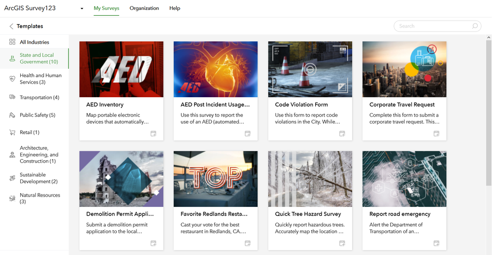

Survey template gallery in the web designer
With the Survey123 web designer you can easily create your own smart forms, visually and from your web browser. The Survey123 web designer is a great starting point for anyone who wants to quickly put together an online form. This update introduces a new gallery of survey templates to help you get started with some pre-configured designs. You can use these templates as they come or modify them to suit your needs.
The Esri templates are categorized by industry. We will progressively add new templates to this gallery.

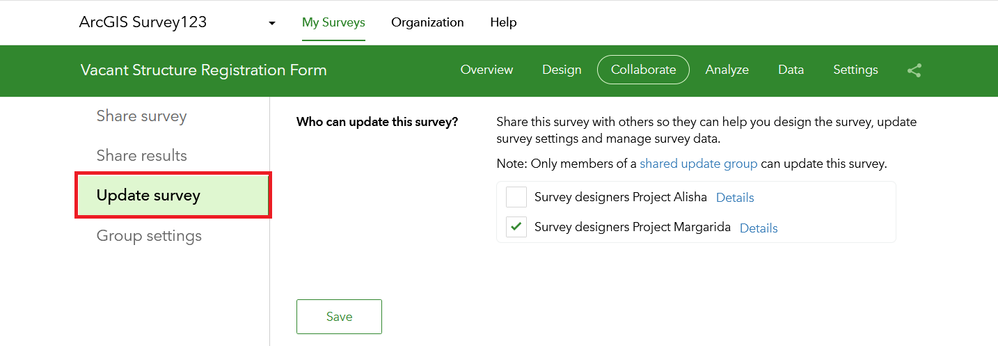

Allow others to update your Survey123 web designer forms
For smart forms authored from the web designer, you can now grant other members of your organization permissions to update your survey. In this way, you no longer need to transfer ownership of your survey for others to work on it or maintain it. To grant others permission to update your survey, you simply need to share it with what is known as a shared update group.
Conceptually, a shared update group is a group where its members can modify items in the group, even if they do not own them. Only the owner of the item can delete the item and change its sharing, but other aspects of the items can be modified by anyone in that group.
Here is a list of a few important things members of the shared group can do:
  • Change the survey design with the Survey123 designer. This includes things like adding, removing or updating questions, re-organize questions in the survey with groups and pages, changing the survey theme and the Thank You screen. In short, anything you can do with the Survey123 web designer.
  • Create, change and add new webhooks. This includes automations from Integromat and Microsoft Power Automate as well as custom web hooks.
  • Upgrade a survey to the latest version.
  • Modify existing report templates.
  • On the Collaborate tab, close the survey or schedule the closing date as well as modify the closing window, change access privileges to the survey or survey results.
Here are the things that members of the shared update group cannot do, unless they own the survey:
  • Delete or move the survey
  • Delete the survey
  • Add new report templates.
  • Change the scope of sharing. For example, adding or removing groups from sharing.
To use this capability, you must first ask your administrator to create a shared update group and invite people to it. Once you are granted privileges to share to a shared update group, open the Collaborate tab of your survey and activate the Update Survey section as shown below.
The list of shared update groups will show in the right so you can share your survey accordingly. If the list is empty, that means that you have not been granted privileges to share items with a shared update group. You will need to contact the  administrator at that point.
I want to emphasize that this capability is only available for surveys authored in designer. Survey123 Connect does not yet support shared survey ownership.  Additionally, please be aware that it is not a good idea to have two persons editing a survey at the same time. This is because the survey design is not locked to a single user and there is no conflict resolution logic. If two people edit a survey at the same time, the last one saving edits wins! That is just like saying that the changes from the first editor will be lost. This feature is not about collaborative design of surveys. This is more about allowing different people in a group to perform maintenance and occasional changes to a survey as needed.

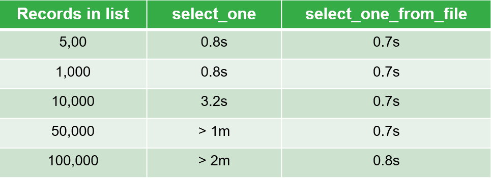

Bigger, faster, better lists in the Survey123 field app
Lists are an important aspect of smart form design. They help us categorize observations, measure levels of agreement, intensity and preference. Lists also allow us to create datasets that can be analyzed more easily. Often, the challenge with lists is their size: How do we effectively work with a list including hundreds, thousands or tens of thousands of choices? How do we make these big lists work fast even in low-spec devices?
This update introduces significant changes around how lists are displayed and filtered in the Survey123 field app. It also incorporates new ways to help you work with big lists. Starting with 3.12 you will be able to handle bigger lists than ever before!
To start, the field app can now handle lists more efficiently. It uses less memory and is much faster. This is accomplished in part through special choice indexes that the app will build when the form is initially downloaded.  You may see a small "Optimizing survey" dialog appear when you load a form for the first time. That's when the indexes are being built! They get built once, and the rest is all joy.
To speed up very long lists, it helps if you use the select_one_from_file and select_multiple_from_file question types in your XLSForm design. You may remember we introduced these in our previous release. I would not recommend using these question types with small lists (up to 200 choices); but with anything larger, these question types will make a noticeable difference. The following table compares how long it takes to load a list in an iPhone when using a select_x versus a select_x_from_file.
As a reminder, select_one_from_file and select_multiple_from_file are equivalent in functionality to select_one and select_multiple, but they get the list from a .csv file rather than from the choices worksheet of the XLSForm. The .csv file must include at least the name and label columns, but you can also add other XLSForm columns to support multiple languages for your labels, choice images and choice filters. Learn more about this from our doc.

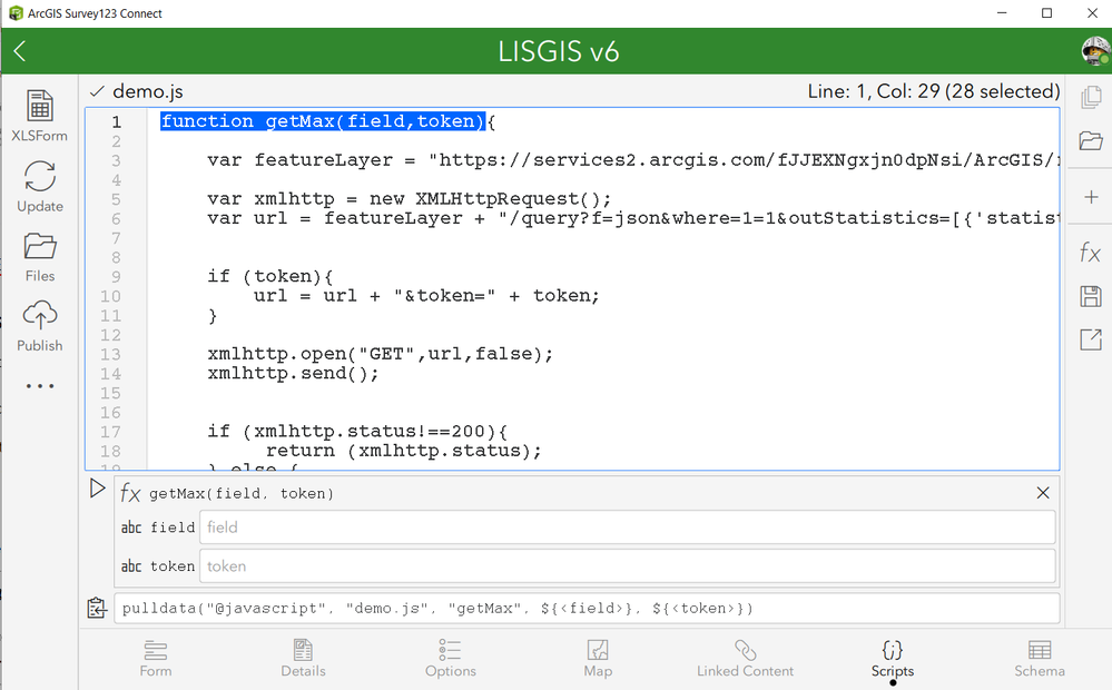

Custom JavaScript function utilities in Survey123 Connect
In our previous update we introduced the notion of using custom JavaScript functions to complement XLSForm expressions. JavaScript functions offer flexibility for handling complex logic that is otherwise difficult to implement in XLSForm
With the 3.12 release, you will now find a new Scripts tab in the bottom bar of Survey123 Connect.
Writing the actual code does not get any easier, but there are a handful of nice features in the Scripts tab to make your work simpler. First, you no longer need to create the scripts folder manually: By adding a new JS function on the Scripts tab, Connect will place your code where it belongs. You can test your code right from the Scripts tab and also copy the corresponding pulldata() function call you need to insert in your XLSForm. You can also launch your script in your favorite developer IDE.
Learn more about the Scripts tab in our help.

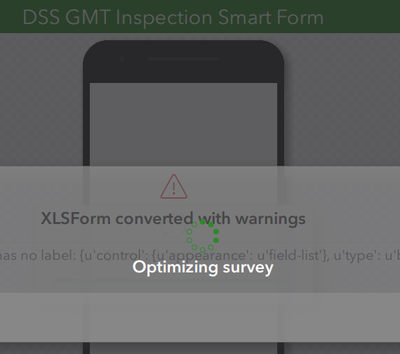

Marie-LouLabuschagne
@IsmaelChivite
I have a survey build in the previous version ArcGIS Survey123 Connect (style: pages theme-grid).  I installed the version 3.12.230 this morning.
The survey has a large number of select_one and select_multiple questions,  each with between 3 and 10 select options. Every time I make a change & save the xls form, the  "Optimizing survey" dialog appear  - and it takes a long time to optimise ...
I can understand that it need to build the indexes, but does it re-build the indexes with every save?  It makes the design much slower.
@IsmaelChivite
The survey has a group for each park.  Each group has select_one questions to "score" a Pass/Fail.  The choice sheet has different values for each Pass/Fail, e.g.
list_namenamelabel
mark_1515Pass
mark_150Fail
I use an integer question with the calculation int(${question1}) + int(${question2})  + int(${question3}) + int(${question4}) to get the total score.
In the previous version, the integer question displayed a 0 when nothing was selected in question1 - 4. As you make the selection in a question, the value of the integer question changed.  So, if only question 2 and 3 was filled in,  the integer question will still add the values selected.
In the version 3.12, the integer question doesn't display any value until question4 is selected.  Is this due to changes in the new version?
Anything I need to do differently to calculate values from select_one questions?
JamesTedrick
Esri Esteemed Contributor
@Marie-LouLabuschagne
1) Yes, the lists need to be reprocessed with every save.  We are looking into checking whether the time a choice list was last saved can be used to prevent this for some lists (external CSV files).  Would you be willing to share your survey so that we could understand why it is taking so long (feel free to email me directly at jtedrick AT esri.com)
2) I'm surprised that you reported this would work when not all questions were filled in before - the design of Survey123 is that empty questions have a 'NaN' value that prevents operation.  If you have questions that may not be answered, you should use the coalesce() function to provide a default value (0, in this situation)

Hussam_AlJabri
Hi @IsmaelChivite  @JamesTedrick @ZhifangWang
I'm suffering with the  "Optimizing Survey" time.
My survey have a list of 1K choices for different questions and every save of the XLSForm take more than 4 minutes which get the process very slow!
ArcGIS Survey123 Connect 3.12.
Please support.
by Anonymous User
Not applicable
Hi @Hussam_AlJabri,
This is likely related to the choice list management and other database related changes made in 3.12 which in some cases with some surveys we have seen that it causes Connect to take a long time to refresh the survey preview.
Good news is that we have made some improvements in the 3.13 beta builds, which appear to resolve this issue. We now have the 3.13 beta builds for Connect and the field app available on the Early Adopter Community. Please take a look and test out the latest beta builds, and let us know if you see any improvements.
Regards,
Phil.
Hussam_AlJabri
Hi @Anonymous User ,
Thanks for your respond. I already tested it in the new version  and it perform better but still the delaying is there and I escalate the observation in the EarlyAdaptor.
