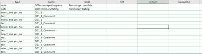

Hello,
I am wanting to achieve a formula that will count how many questions have been answered no matter what the answer is and divide this by how many question there are.
Basically i want to calculate the top row (GDPercentageComplete) with how many of the questions from GD1_1 to GD6_6 (except the comment/text fields) were answered (it does not matter what they were answered with) and divide this by the amount of question as i would like this as a percentage.
Any help would be greatly appreciated.
Thanks,
Jaime
by Anonymous User
Not applicable
Hi @Anonymous User,
Yes this is possible using hidden questions to ensure each select one has a 1 or a 0 value and then add them all up, or you can do it in one calculation if yo uput all the if() in one calc and add them in that one calc.
If you add a hidden question after each select one question that has a if() calculation, to say if it is null, assign it 0, otherwise assign it 1. That will give that hidden question value of 1 or 0.
You can then add those questions up in a sum to know how many have been answered and then convert it to a percentage.
Or if you prefer not to add so many hidden questions, you can do it all in one question and just add them all together and then sum and convert to percent. Will be a bit more complex and harder to compile, but easier in the form with just one question with the calc.
Regards,
Phil.
by Anonymous User
Not applicable
Hi @Anonymous User
Thank you for your input this has worked a treat. I have now published this onto AGOL and I'm getting NaN in the Percentage Complete field. Is there something I can do to fix this?
Thanks,
Jaime Smith
by Anonymous User
Not applicable
Hi @Anonymous User,
Are you using the survey in the web app or field app, where do you see the NaN?
It sounds as if there is a null value tried to be summed or used in mathmatical expression. Need to ensure every field that is used in the expression has a 0 or a real value, and not a null value.
If you can share your xlsx file I can take a closer look and get back to you.
Regards,
Phil.
by Anonymous User
Not applicable
Hi @Anonymous User,
I had a look at the survey you sent me. Are you referring to the expression in Percentage Complete field which is:
${Decimal2} div 4 *100 +"%"
This expression appears to be mathmatical and text concatination in one. This is not expected to work, either in field app or web app. If it does work in field app that is by chance more so then by design. You need to seperate this expression into two different expressions (use hidden and/or null field types), the first being the mathmatical expression to get the result, and then the second to concatenate that result with the % sign (string). Use the concat() expression to do this, not just a + sign. This will work in both field app and the web app. Then only show the note to the user, not the hidden fields.
Also note that your survey uses grid theme, however this is currently not supported in the web app.
Regards,
Phil.
