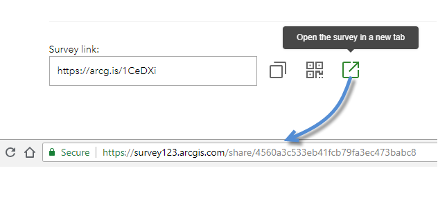

Copy the Survey ID number from the survey link and save it for later.

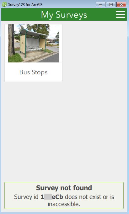

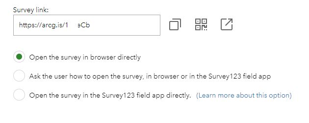

I have been able to create my URL no worries in the pop-up, but it seems the URL structure has changed since this blog was written.
This is what I am presented with in my collaboration tab of survey123 site:
My Survey Link (in collaboration tab of https://survey123.arcgis.com)
This is the sample that we are given in the above blog:
Blog Sample
I am wondering what my URL should look like? My URL is vastly different to the blog example.
The blog example looks like this:
arcgis-survey123://?itemID=4560a3c533eb41fcb79fa3ec473babc8&field:TRAILNAME={TRAIL_NAME}&field:MAINTENANCE={MAINT_BY}
But my URL ends up looking like this:
arcgis-survey123://?itemID=1XXeCb&field:asset_id={OBJECTID_1}
And when i open the URL it gives me this:
Error
Any tips on how to fix this one?
Thanks!
MarkBockenhauer
Ben,
You can click to open the survey in a new tab and that will show the full URL in the browser address.
Mark
BenVan_Kesteren1
Deactivated User
Works perfectly with that suggetion Mark Bockenhauer, thanks for the tip!
