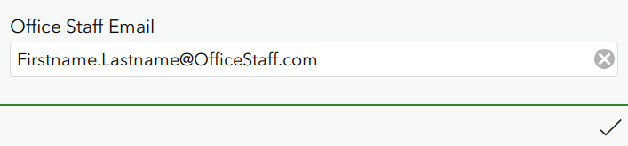

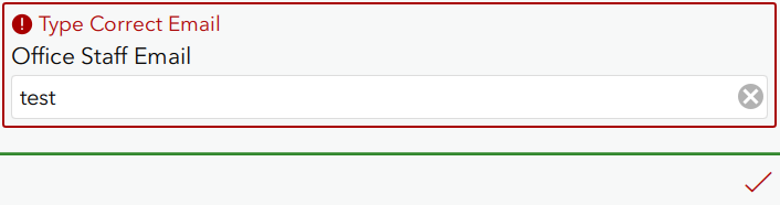

ThomasHamill
@MichelleWilliamsERM, why not implement this as a constraint?
In the constraint column:
 regex(., '[A-Za-z0-9._%+-]+@[A-Za-z0-9.-]+.[A-Za-z]{2,4}')
In the constraint_message column:
Type correct email
