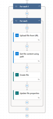

A similar approach can be used to upload files into SharePoint as shown in the following screenshot:
When uploading photos into OneDrive or Sharepoint, you do not need to initialize an array variable at the beginning of the flow.

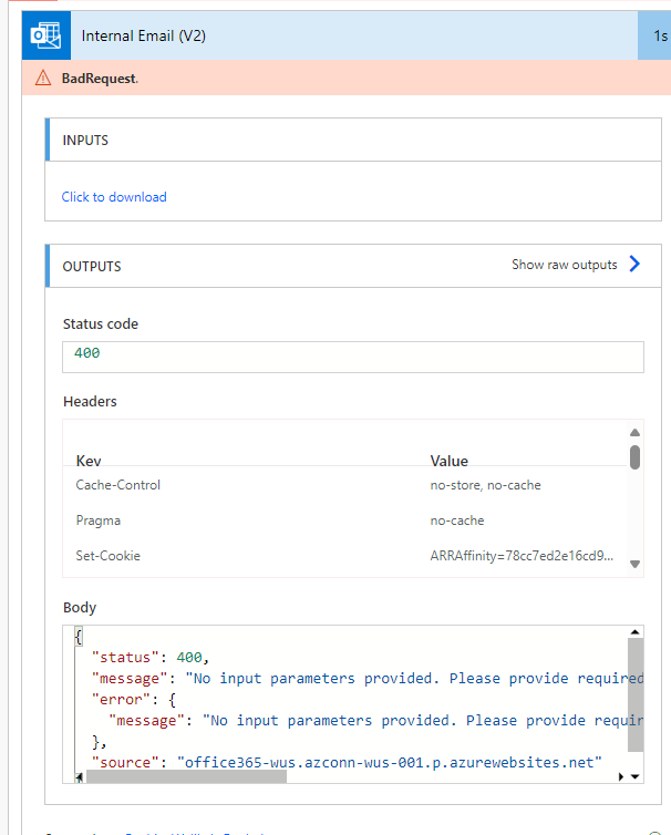

Thank you @IsmaelChivite for this detailed workflow. In the Advanced settings step of the email, I am seeing something different from your single "Incident Photos" variable. It is asking me for the same json format as the append to array variable action as soon as I press the button "Switch to input entire array". Can you please assist?
Can I put the dynamic content Photos variable in place of the json? It says "Attachments Item" where yours says "Attachments" so I am not sure if that is the same.

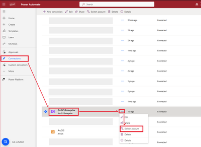

I would definitely try refreshing the connection.
  1. Click Connections
  2. If you are using Enterprise, look for the purple ArcGIS Enterprise connector.
    If you are using AGO, look for the orange ArcGIS connector.
  3. Click the ellipses (...)
  4. Click Switch account and log in using an account with appropriate permissions.
After that, try the flow again. Honestly, it should work after this. If it still doesn't work, jumping on a call with Esri Tech Support may be a good next step so they can see exactly what you have configured.

That worked, I had to delete all my cookies to ensure I was switching to the correct account.
Thanks!
