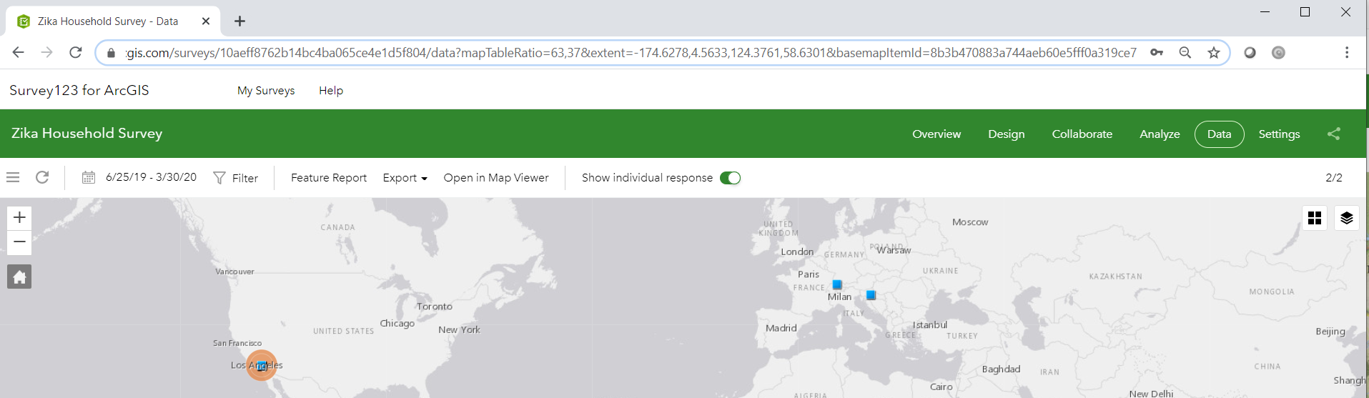

If you look carefully, you will notice that as you work on your Data and Analyze tabs, the URL in your browser reflects your choices. In the screenshot below, for example, observe that the URL in the browser has a bunch of parameters specifying the currently selected basemap, map extent, filter and other properties in the Data tab.
What this essentially means is that you can now easily copy the URL, bookmark it for later use or even share it with other people that have viewer access to your survey. That is, in short, a Survey123 website link!

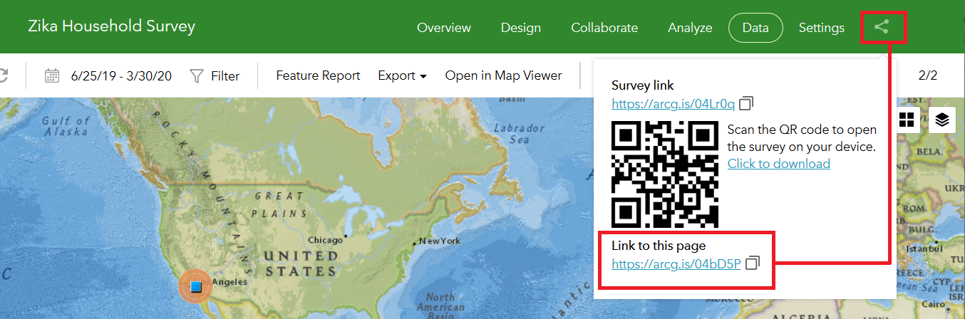

For your convenience, you can also grab the link to your survey123 page as shown below.
Survey123 website links are particularly useful with the Analyze tab. Your preferences to use one type of chart or another, hide or show specific questions or even your own filters will all be encapsulated in the page link. In this way, you can save bookmarks to easily return to your preferred survey results view.

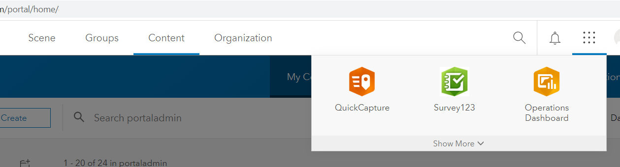

While you can obviously bookmark the URL above to reuse it, it is much better to modify your ArcGIS Enterprise app launcher to include a shortcut to the Survey123 website. That way, anyone in your organization can easily access the Survey123 website without having to remember the syntax of the URL.
You will find step by step instructions to create your own Survey123 website shortcut in the app launcher of ArcGIS Enterprise in this Technical Support Article.
