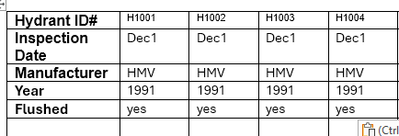

First, we will create what is known as repeat section. When a repeat section is encountered by the Survey123 report engine, all contents within the section are processed for every record referenced in the repeat. A repeat section is opened with ${#LayerName} and is closed with ${/}. As you can see in the screenshot below, the layer name needs to be replaced accordingly. You can get the layer name for your survey from the reference table in the Upload new template dialog.  In the context of Survey123 report template syntax, the # sign in the opening tag is an indication that the section is a repeat.
If you were to upload and run a report with the template above, new rows will be added to the table: one row per survey record. To complete the table, we need to make sure we have instructions to pull values from the corresponding fields.  The table for our survey will look like this:
It is important to note that out of all the Survey123 report template syntax we have added in our table, some parts will not be included at all in the output, and others will be replaced with data.
  • The repeat section opening and closing tags will not be included at all. This means that you can use whatever formatting you want in your design to make it more legible.
  • The syntax to retrieve data from fields will be replaced with values from the records, so the formatting you apply to your report syntax matters. For example, if you insert an instruction like ${asset_id} setting the font color to blue, then the Asset ID will be rendered blue in the output report.
To be more exact, to define the formatting of your field values in the output report, you do not need to change the format for the entire Survey123 report template syntax. The only character that matters is the initial $ sign. This is important because sometimes the syntax can be long and interfere with your design. A good example is the Inspection Date in our sample. It uses three lines in the cell, affecting the height of the whole table in the design view.  To avoid this, use a smaller font size for the expression and apply the font style you want for the Inspection Date to the $ sign only. Here is an example of a sample preview report with various formatting styles applied:
At the end of the table, you can see an empty white row. If you do not like that, go into you report template design and remove it from the table.

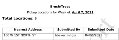

Is there any plans for incorporating a single map into a summary section. We're working on a project that would drop locations of bulk waste/brush to be picked up using QuickCapture. I want to take all of those locations and put them on a single map, along with a list of addresses that has been reverse geocoded from the QuickCapture points. I have the summary table set up to create the list of addresses, but I'd like a map that shows all of the points on a map so they can plan their route to pick up at each location. Currently, the drivers don't have the ability to use Survey123 or Workforce to mark a pile as picked up.
Another obstacle I just encountered is how to automate a summary report in Integromat when a "survey" is not being submitted. if the points are created using QuickCapture, then I want to print a list of locations to be picked up for the driver, how might I go about creating that summary report through Integromat?
Sample report template:

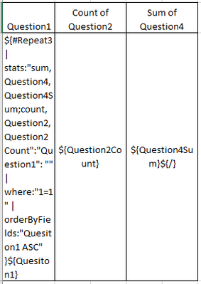

Hello, I have a survey that contains a repeat which is 3 levels deep. Parent, Repeat1, Repeat2, Repeat3, which contains data that I would like to utilize within a Summary Section of a Custom Report. I have three questions that are going to drive the summary table listed below -
Question1 contains 3 dozen choices that categories a main category,
Question2 contains 4 choices relating to the condition of the finding in Question1 – Condition1, Condition 2, Condition 3, and Condition 4, and
Question3 contains 3 choices relating to a status rating of the finding in Question 1 – Status1, Status2, and Status3.
Question4 contains 2 values or “0” or “1” which are assigned based on answers to Questions1. If Question1 = “Choice 36”, then “0” otherwise “1”. I had planed on using this within a pivot table for summaries.
The end goal for the Summary table would look something like this table below.
However, I can only seem to get to this stage of the game and there is an issue with the results of this table. I have tried multiple combinations of queries, but the stats are being pulled for the "entire" repeat and not just the specific parent record report that I have chosen?
This is the query that I came up with based on the information from the “Group by summary Tables section of this article.
${#Repeat3 | stats:"sum,Question4,Question4Sum;count,Question2,Question2Count":"Question1": "" | where:"1=1" | orderByFields:"Quesiton1 ASC" }${Quesiton1}
However, this pulls data for “ALL” records within Repeat3. I would like for the values being reported only be based the Repeat3 records that are related to the selected Parent record.
So, I tried to use the information to “Limit the repeat block to selected Question1 records that have a Question2 = ‘Value1’ of within this online help section https://community.esri.com/t5/arcgis-survey123-blog/survey123-tricks-of-the-trade-summary-sections-i...
I would leave the Custom Report Summary table the same as above, but I would substitute this within the block below the ${#Repeat3 | stats:"count,objectid,Question2_Status1" | where:"Question2 = 'Status1'"}${Question2_Status}${/}
Everything will check out when uploading the custom report, but when I attempt to export the report there is either an error of “Failed to convert to PDF” or when using the export to Word Document the doc is corrupted.
Here is what I used within the table below.
${#Repeat3 | stats:"sum,Question4,Question4Sum":"Question1": "" | where:"1=1" | orderByFields:"Quesiton1 ASC" }${Quesiton1}
${#Repeat3 | where:"Question3 = 'Status1'" | stats:"count,objectid"}${/}
${#Repeat3 | where:"Question3 = 'Status2'" | stats:"count,objectid"}${/}
${#Repeat3 | where:"Question3 = 'Status3'" | stats:"count,objectid"}${/}
Any insight to achieving the end summary table would be greatly appreciated.

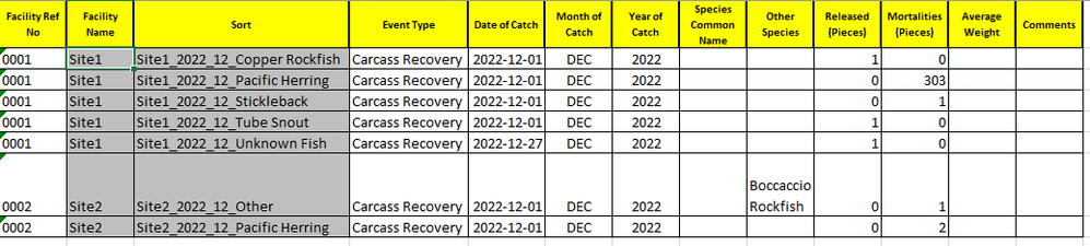

@IsmaelChivite. Great article and great resource.  I have a survey where people can put in several records of Bycatch throughout a month (site, date, Fish species and number released and number died etc).  I want to create an aggregate report to summarize by site, year, month, Fish Species, and total number released and total mortalities.   As such I have a summary report that I created to aggregate all the fields from the original survey by grouping them by a sortfield (a concatenation of Site, Year, Month, FishSpecies) to give distinct values.  This works great to populate the data table needed on 11/12 fields of various types (like facility #, site Name, Date, Month, Year, FishSpecies, OtherSpecies, sum Mortalities, sum Released, comments), using min stats for both text and dates etc. Syntax is verifying and report produces without errors, also gives me what I am looking for results for  11/12 fields except one field will not populate (FishSpecies).  I have tried first, last, min and max stats (last is the only stat that does not seem to crash table when creating) on this text field and it still will not populate, yet field beside OtherSpecies is also text and populates completely fine with min stat.  Any help will be greatly appreciated, as I know I am pushing boundaries with aggregating text fields and cannot see tons of documentation in that regard.
here is the first column of the summary table that works out all the stats:
${#Report_Details|stats:"min, Facility_Ref_Nbr, Ref_Nbr; min,Facility_Name, Name; min, Sort_Concat, Sortfield; min, Date_of_Catch,DateCatch;min, Month_Of_Catch, Month; min, Year_Of_Catch, Year; last, Species_Common_Name, Spp;
min, Other_Species, OtherSpp; sum,Released_Pieces, sumReleased; sum, Mortalities_Pieces, sumMort; avg, Ave_Weight, aveWeight; min, Comments, Comms":"Sort_Concat"|where: "Event_Type='Carcass_Recovery'"|orderByFields:"Sort_Concat ASC"}${ Ref_Nbr}
then I have a table with a column for each aggregate field
${Name}
${Sortfield}
Carcass Recovery
${DateCatch}
${Month}
${Year}
${Spp}
${OtherSpp}
${sumReleased}
${sumMort}
${aveWeight}
${Comms}${/}
In the survey Name, Spp are both Choice fields in the xlsForm, whereas OtherSpecies is just open text box.  so not sure why I can pull min Name, and min OtherSpecies but not min Spp.
End table looks like this (some information has been changed for privacy reasons). I would like Species Common Name field to have the fish species populate (i.e. record 1 would be Copper Rockfish).

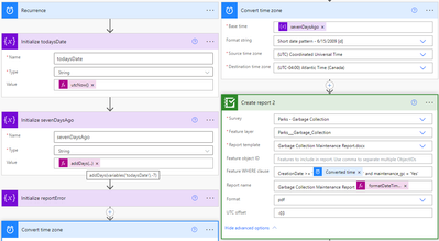

@RobertAnderson3 Im trying to create this using automate, how do you get it to pull just the past months records automatically?
RobertAnderson3
MVP Regular Contributor
Hi @LydiaCarey I have it set up using variables to keep track of the current day and plugging that into the WHERE clause for the Create Report function.
I start with todaysDate from utcNow(), then set 7 days ago using addDays(variables(todaysDate),-7) where as you'll put in I guess -30? I don't believe there is an addMonths function.
Then in the WHERE clause I have CreationDate >= 'converted timewhere the converted time is dynamic content from the variable I set previously.
The reportError I am setting is set up so I can use it in a condition statement later if it returns no records in the query. I can walk through that step too if interested.
In my case it runs Saturday night, and no surveys would be done on weekends, so I can't promise it's working EXACTLY as I think it is date wise, you may need to play around with the recurrence and number of days and timezones a bit to make sure it all lines up.

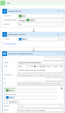

RobertAnderson3
@LydiaCarey Have you gotten a report emailing with Power Automate before and it's just this one causing an issue or is this the first time?
This is the way I have the flow set up for the email attachment.
Not sure if the issue, but an important part to remember, make sure you click the name/url that says 'of the first result file'
Otherwise can you share your flow so I could see what's going on?

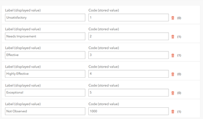

jzibbell_boise
@ISM I have a field that is an integer, but I think the report template is pulling the label. I'm trying to force it to look at the value instead of the label, but I'm getting syntax errors.
Communication Evaluators: ${Boise_Fire_360_Evaluations_1| where: “reviewer<> ‘self’ AND personnel = ‘name’ !important ”| stats: “avg, ${communication | getValue:””}”}
OR if I use the normal syntax without the getValue attempt:
Communication Evaluators: ${Boise_Fire_360_Evaluations_1| where: “reviewer<> ‘self’ AND personnel = ‘name’ !important ”| stats: “avg, communication”}
Error: An error occurred when checking the report template. Failed to parse ${Boise_Fire_360_Evaluations_1| where: “reviewer<> ‘self’ AND personnel = ‘name’ !important ”| stats: “avg, communication”} since avg cannot be applied to the current field.
