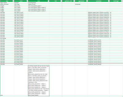

If I have a multiple select question in a parent table that is populating a repeat table how do I get the repeat rows generated to automatically populate instead of cycling through each repeat record to calculate the value from the select multiple.
abureaux
MVP Frequent Contributor
@SamBialoruckiCalculates within Repeats will only trigger for the active record. There is currently no way around that at this time, though I hope that changes in the future.
SamBialorucki
Frequent Explorer
@abureaux Thanks for the response. That is unfortunate.
