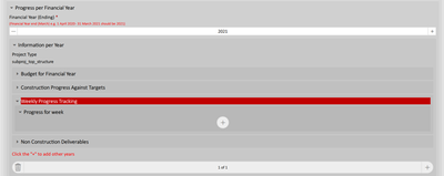

Does Survey123 still honor the "minimal compact" appearance to stop it from creating a blank record?
I have a survey with that exact setup but Survey123 still creates a blank record:
The Progress for Week repeat is inside the Financial Year repeat. But its appearance is minimal compact.
Even without clicking on the + for Progress for Week a record still gets created in the database:

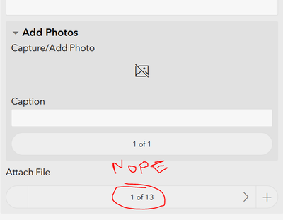

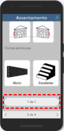

Is there a way to hide the repeat count and navigation buttons on the form?
I'm working on a form that populates different related tables, according to the event type being reported. For this I have different repeat groups that only appear when the correspondent event type is selected. I only need the repeat group questions to be answered once (I've set the repeat_count to 1), but in the form stills appears the "1 of 1" repeat count. Is there a way to hide this?
Thanks
DougBrowning
MVP Esteemed Contributor
You can put a relevant on the begin repeat line to hide it.
CarlosSousaFerreira
Hello, @DougBrowning !
I'm not looking for hiding the whole repeat group, but just the repeat records count that appears at the end of the repeat group:
DougBrowning
Nope you cannot change the UI for repeats in 123 at all.  You can set border and background colors but that is pretty much it.

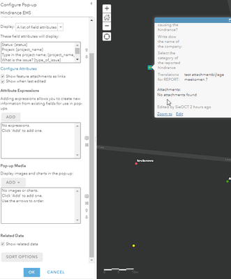

FrederikPicavet

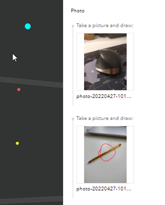

Hi,
I have made a repeat question, for a picture (so making pic1, pic2, ...)
Now I want to configure a popup, but the list of attachments is empty:
The expression {photo} is not in any list ....
What am I missing ?
MariaC
New Explorer
Silly question, is it possible to create repeats while using the web browser version to create a survey?
CarlosSousaFerreira
@FrederikPicavet: I'm probably late for commenting on your question, but, when you create a repeat question, a related table is created in the data model and is that related table that will have the photos attached.
I faced the same issue and managed to show the first attached image is this manner:
  1. Created an expression to get the url for the attached image with a code similar to:
var url = 'https://services.arcgis.com/<whatever>/ArcGIS/rest/services/<service_id>/FeatureServer/<photos_table_id>'
var photoid = ''
var photo_rec = First(FeatureSetByRelationshipName($feature,"<name of the relationship for the photo label>"))
if (photo_rec != Null) {
    photoid = photo_rec["objectid"]
return url + '/' + photoid + '/attachments/' + photoid"
2. Then I inserted a image in the popup using the previously calculated url

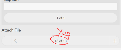

LiamHarrington-Missin
When editing, can you have a repeat start on the latest entry rather than the first?
Hi all,
When you are editing a survey which includes repeats and reload it from your inbox, overview or sent items, the repeat question starts at 1.  For my use case, that's inconvienient, I'd rather it load in and start on the most recent edition.
The work around is to press the plus button, which creates the next entry and then use the delete button to get back to the latest record.  That's all well and good when you know the trick, but not ideal.
DougBrowning
If you long press on the arrow it will go right to the end for you.  Same with the other arrow, long press and it jumps to the beginning.
For pages tap the Page 2 of X part and it will give you a list of pages to jump to.

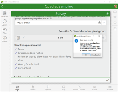

I'm attempting to apply the "required components" of repeat as described in the heading "Aggregation function (join).
Here's what I got:
typenamelabelcalculationconstraintconstraint_mesage
begin repeatPlant_Group
Plant Group Species Richness
select_one plant_group or_otherm_plantGroupPlant Group
end repeat
select_multiple plant_groupm_plantGroupAllPlant Groups estimatedjoin(",",${m_plantGroup})count-selected(${m_plantGroupAll})=6All six plant groups must have species richness and percent cover values.
The thing is, each of the plant_group options don't have to be selected. I could select 6 vine groups and it is passing the form validation. Or in the case below, I made 2 vine groups and 1 of each of the other checked.
Can I somehow get it so the data is not validated unless each of the six groups are chosen?
