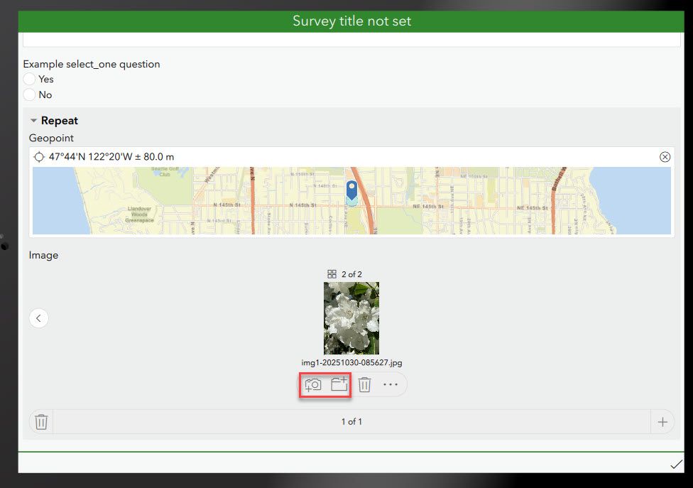

One question, multiple photos
If you want users to submit more than one photo with your survey, you can either add multiple image questions or alternatively use the multiline appearance on an image question. There are good cases for both approaches. For now, lets start with the multiline appearance:
typenamelabelappearance
geopointlocationIncident location
imagephotoIncident photosmultiline
Support for the multiline appearance for image questions was added in version 3.10. When using the multiline appearance you will initially not see much of a difference in your form. However, after you take the first photo, you will see that new options appear for you to take additional photos and navigate through all the photos you have taken.

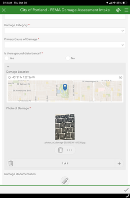

Image questions and repeats
Support for the multiline appearance in image questions was added with version 3.10. Before that, if you wanted users to upload more than one photo you had to either add multiple image questions to your survey or include the image question within a repeat. Adding multiple image questions in a survey is still a valid pattern, as we will describe later. Creating a repeat block simply to include a single image question is never a good idea, because the repeat will create a new related table and your attachments will link to that table. It will be extremely difficult for you to later explore the attachments in ArcGIS that way. Instead of using a repeat for that, use the multiline appearance as described above.
typenamelabelhint
geopointlocationLocation
begin repeatphotosPhotosDo not create a repeat just to add a single image question in it. Use the multiline appearance instead on the image question (as shown above)
end repeat
For clarity, this is not to say that you should not include image questions within a repeat. For example, If you want to have a repeat and then add an image question along with a text question for a description or something else, that is all good. It is adding a repeat containing just an image question that should be avoided.
Here is an example where having an image question within a repeat is justified. In this case, the repeat makes sense because we want to associate multiple attributes (Direction, Latitude, Longitude as well as a user entered description) with every photo.

Is there a way to have an image repeat inside a geopoint repeat?  I'm working on a form (for damage assessment) and we want multiple locations each of which can have multiple photos.  For example, a facility could have multiple reports of damage (each with a location) and then each damage report could have multiple photos.  I have set up a repeat and then inside that a geopoint question and an image question with multiline appearance, but I only get the geopoint repeat.  No image repeat.  Is there a way to do this?
JamesTedrick
Esri Esteemed Contributor
@PaulCone2 - The multiline appearance does not create a full repeat; rather, after adding the first image you will see buttons to allow you to add additional images:
begin repeatr1Repeat
geopointlocGeopoint
imageimg1Imagemultiline
end repeat
PaulCone2
@JamesTedrick hmm... that's what I have set already in the .xlsx but that's not what I'm seeing in my survey...
