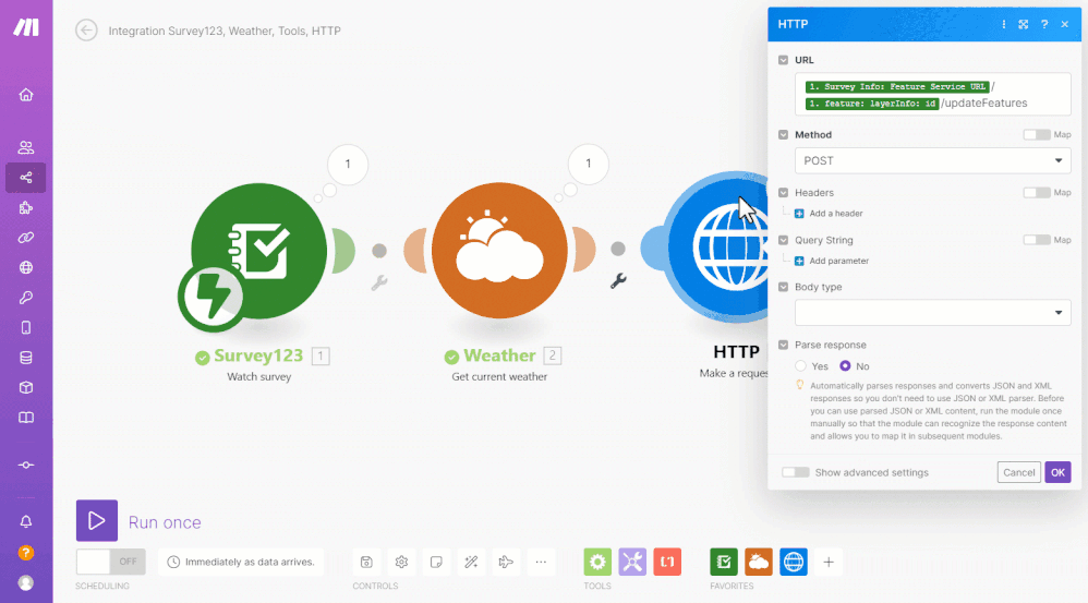

The mechanics for using the 'Make a request' action imply good knowledge of the target web service your are invoking. I will use next a simple scenario to illustrate the essence of this technique. Say for example we want first to get the location of a submitted survey record, get the current temperature at that location using a weather service and store that temperature value as a GIS attribute of the feature that was originally submitted.
Here is how you get the current temperature. OK: so far we are not using 'Make a request' anywhere. We are just setting this up.
Next, we are going to 'Make a request' to the survey feature layer using the ArcGIS REST API to add the temperature to the temperature field of the submitted record. Specifically, we are going to make a request to the Update Features REST API operation. This operation, as described in the Updates Features ArcGIS REST API Developer documentation, is located at:
https://<featurelayer-url>/updateFeatures
All information needed to construct the URL above is included in the survey web hook payload. It is a matter of combining the surveyInfo.serviceUrl and the feature.layerInfo.id properties, followed by updateFeatures.
Again according to the doc, this operation only supports POST requests and the encoded parameters include:
  • f to define the output format as json or html. This is optional but handy so we can debug, if needed, the output within Make.
  • token to specify a valid token we can use to securely access the feature layer. This parameter is not needed if the feature layer is shared publicly.
  • features to define the actual updates we want to make in the layer. The content of this parameter is a json object with information about the records and fields we want to change.

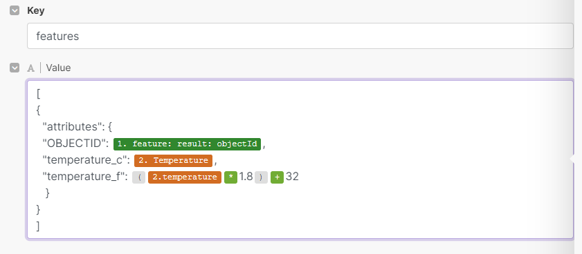

The most error prone step is adding the exact JSON value for the features parameter. I like to copy the sample JSON that comes in the developer documentation, and then modify it for my own purposes.  It is very important to note that the sample JSON in the documentation must be enclosed with extra brackets as shown in the example below.
Note that the objectId in green, and the temperature in orange are dynamically populated using outputs from other modules in the scenario. Also note the square [] and curly brackets {} I added
    "attributes": {
    "OBJECTID": 14,
    "temperature_c": If a number do not use quotes,
    "city": "If text, use quotes"
You will see yourself going through some trial and error until you get it right, but since you can easily look at the output of the 'Make a request' operation, it typically does not take very long before you figure things out.
