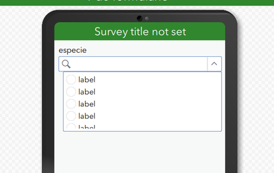

If you ever see Connect display a list like below, unable to display the proper labels, make sure your CSV file includes a column called label.  It is common to get CSV lists from other systems lacking a label column. Always remember to rename one of the columns as the label!

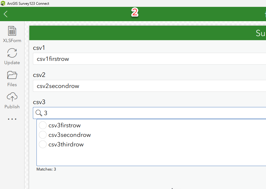

When I test the survey in the Survey123 Connect application, all 3 fields populate just fine.  When I test the survey in the web version, the field referencing carrots.csv does not populate, it's blank (it doesn't even get the empty 'label' values).  If I remove bananas.csv from the XLS form and republish, then the field referencing carrots.csv will populate correctly.

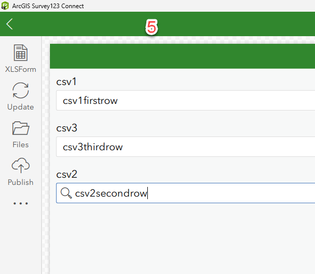

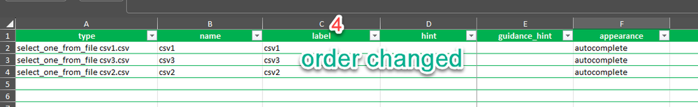

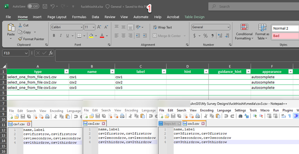

No special chars, made some brand new csv files, 3 lines each.  It's not the CSV file contents.  Same thing.  But here's the newfound plot twist.
  • Survey123 Connect - Works
  • Web Survey - Does not work
  • Field App - Works
1 - XLS and CSV files
2 - Works in S123C
3 - Does not work in web version
5 - Works in S123C
6 - Same CSV files, just swapped order in the XLS form
It's great that it works in the field app, most of our work will be done in it but still need to get this figured out.  Please tell me I'm missing something that's staring me in the face, because I'd like to end this week on a positive note.
