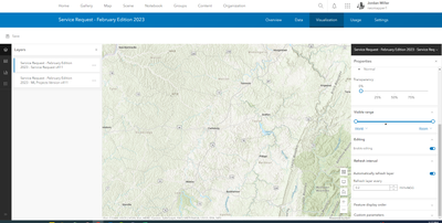

Did you turn the automatic refresh rate on the feature layer it's self?
Open your feature layer> go to Visualization > Properties > Refresh Interval group (default is turned off.. turn it On) > Save
RobertAnderson3
MVP Regular Contributor
@neomapper I think the struggle I'm having is that I don't actually include a map in my dashboard. So I don't have the layer saved in a map for it to turn that on.

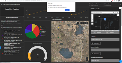

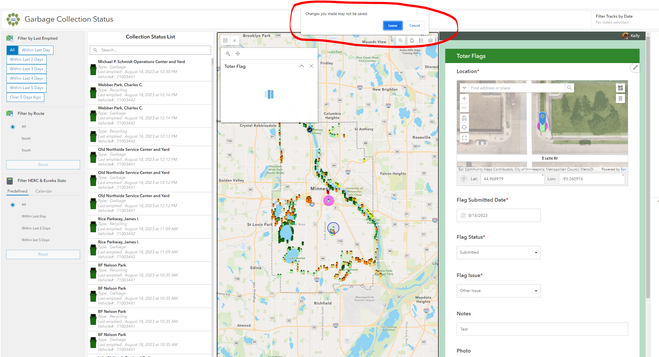

Hi Ismael,
First of all thanks for the post! I'm trying to set this up and for the most part it works great except for one thing: when I switch the survey by clicking on the item in the list I always get this popup suggesting that a change will be lost, even if the survey hasn't been edited at all. Do you know why that might be? Is there a configuration that I could set to adjust it or a way to not make the survey editable right away after clicking a list item?
ArmstKP
@IsmaelChivite I am having the exact same issue as @ZachBodenner  above.  When I have my survey form open in a dashboard with actions configured in the map, so when I click on a feature, it will open up the associated S123 survey.  The issue I am having is if I go click on another feature on the map to open up its S123 form to edit info, I constantly get this popup error about leaving the page.  Even if I don't edit info and click on a feature to open up and edit its form, I will get the popup to Leave or Cancel:
ZachBodenner
@ArmstKP  just an FYI I didn't manage to solve this in dashboards yet, but if your configuration can be replicated in Experience Builder, you might try that. I added mine to a side panel so users can choose whether they want the survey visible at any time. That solved the issue with the refresh (actually even before putting in the side panel, so that part is exactly necessary), plus you can set it up so both the map and the list trigger the relationship with the survey.

@ZachBodenner @ArmstKP  I have been trying to reproduce the problem you describe without success. If you send an email at survey123@esri.com I will organize a quick call so we can look at this in more detail. I am curious to learn how to reproduce the problem. Thanks!

@IsmaelChivite  - We are also having this same exact issue where it will keep popping up over and over when new records are selected. This popup is probably one of our biggest complaints with the survey123 embed on a dashboard.
IsmaelChivite
Esri Notable Contributor
@neomapper  I hear you! 🙂  Please email survey123@esri.com so we can look at this in more detail. Looking forward to learn what is causing the problem so we can address it.
IsmaelChivite
@ZachBodenner @ArmstKP @neomapper  To prevent the 'Leave Site?' popup dialog to appear, add the leaveDialog element to the hide parameter of the survey url.
For example:  &hide=navabar,header,leaveDialog
ArmstKP
@IsmaelChivite Bingo, works like a charm!  Thanks for creating this fix so quickly!

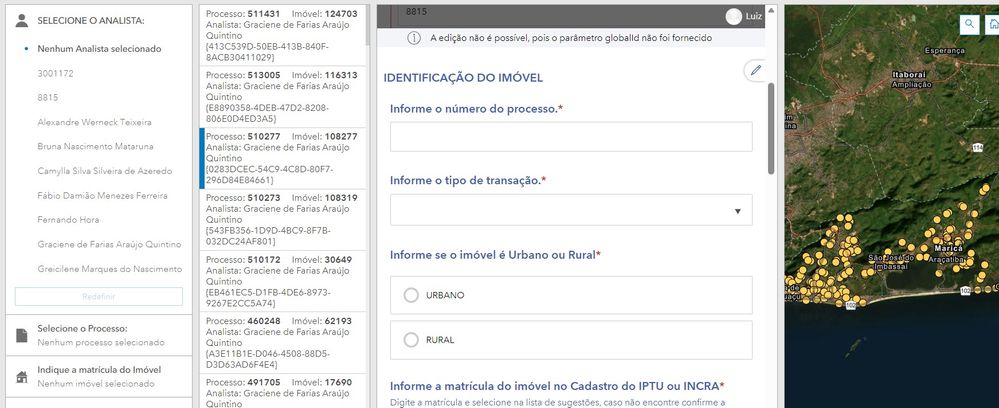

Helô, @IsmaelChivite
Segui seu tutorial, mas ao selecionar um registro da lista, aparece a mensagem: "A edição não é possível, pois o parâmetro globalId não é fornecido".
No entanto, verifico se o campo globalid existe na camada de formulário.
Quando configurei a ação de lista e optei por filtrar o conteúdo incorporado, não havia como escolher os campos de relacionamento, entendo que o filtro é automático pois o banco de dados é o mesmo.
 A URL inserida:
https://survey123.arcgis.com/share/19c53fb2f2f04c8eb551be3fd4b89d1a?portalUrl=https://meuportal/port...
Alguma dica sobre o que posso fazer para passar o parâmetro corretamente para o formulário?

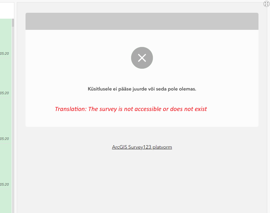

Hi
We also often use the Dashboard+Survey123 combination to make data inputs/corrections and it is really nice workflow for end-users.

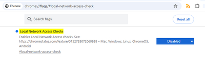

Recently, we have encountered the problem that the Chrome web browser no longer displays the Survey content embedded in the Dashboard, it still works in other browsers, but it is little weird to say our end user that please use an ohter browser. Does anyone know if there is a workaround solution to be expected what is not "Please use an other browser"?
Survey_errorSurvey_error
Ruth_JiatengXu
Hi @LiisiPark ,
The issue you encountered is caused by the new local network permission introduced in Chrome 142. We should have fixed it in the ArcGIS Online and Enterprise 12.0, but it still impact the older Enterprise versions. Here is the related Esri support issue: https://support.esri.com/en-us/bug/in-arcgis-dashboards-the-embedded-content-element-conta-bug-00018...
The workaround is to disable the "Local Network Access Checks" in chrome://flags/#local-network-access-check as shown below:
I also encourage you to contact the Esri Support and attach your case to BUG-000180846, so we can track the impact of this issue.
