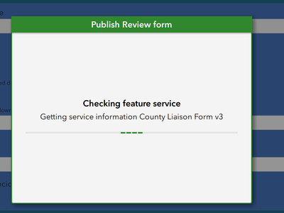

GaryBowles1
When I try to save the survey in collaborate on the survey123 website i get the following error:
Thanks,
--gary

IsmaelChivite
Esri Notable Contributor
Hi Gary, since you are using ArcGIS Enterprise, the parameters in the URL should look like this: &mode=edit&globalId= This is because your survey URL already has the ? sign to pass the portalUrl parameter. I made a slight modification in the blog post to be more specific about this. Thanks!

ShaddaiSpencer
New Explorer
Hello,
I have tried this and I made sure these surveys were share and published but I am getting the checking feature service and it is not publishing. It is just stuck there. This is what it is giving me on the review form. I did use the right url I believe from the original submission survey so this is just my survey for marking these as complete or in progress. Do I need to not have spaces in the form id or is this a different issue?
