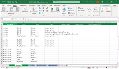

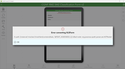

I am attempting to use a choice filter, that references a filter column in my choices list with multiple options separated by a comma, as in the example above. When I implement the filter expression I receive an error message that the expression broke the parser and the result is invalid. I have checked the expression and references multiple times but cannot figure out what is generating the error. Could someone assist.?
The fields referenced in the expression are in yellow highlight below.
The choices list referenced in the above choice filter expression contains(feats, {FEAT_ASSESSED}) is shown here:
And the error message is shown here:
abureaux
MVP Frequent Contributor
There is a period at the end of the equation. Try removing that.
BryceHancock
Good catch. Can't believe I missed that. Removed and it works! Thanks!

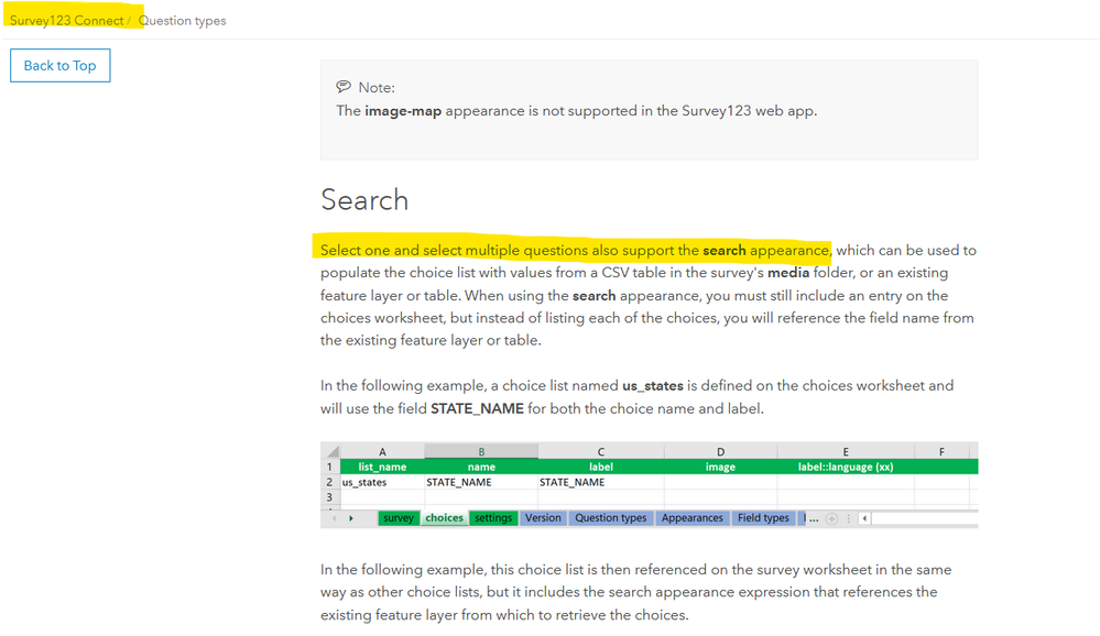

Hello @IsmaelChivite
Please, I need help with a problem with Survey123 Connect.
The issue is that in a select_multiple question (from choice sheet or from a csv file), it does not allow me to search. This link indicates that it is possible to do so (https://doc.arcgis.com/en/survey123/desktop/create-surveys/xlsformsappearance.htm#ESRI_SECTION1_46A7... )Captura de pantalla 2025-11-20 131422.pngCaptura de pantalla 2025-11-20 131553.png
I need to be able to use it correctly on the web, but I have to create the form in Connect because there are other questions that require extra functionality.
Is there a solution? The search function works for a select_one question, so why not for a multiple choice question?
