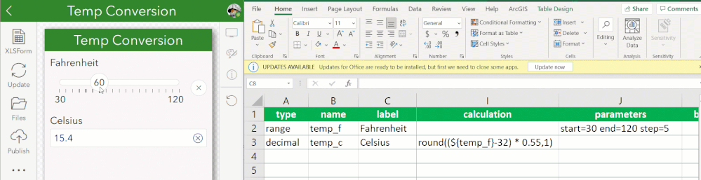

Calculations are used for different purposes. Sometimes, we want to save the end user from answering questions for which we already know the answer. For example, the age of a person can be automatically calculated if we already know the birth date.  If we are given the length of a pipe and the price per meter, we can also calculate the total price of the pipe.

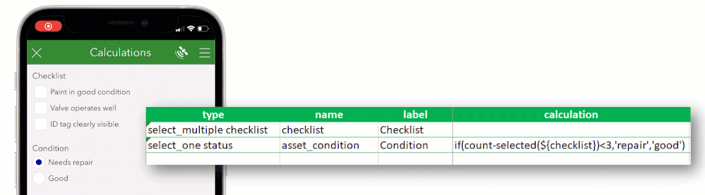

In other occasions, we use calculations to provide a best guess, which the user can override.
This blog post introduces the concept of calculation modes. They will allow you to better control when  calculations are evaluated.
Calculation mode: auto
Unless specified otherwise, calculations are always executed in auto mode. When in auto mode, calculation expressions are evaluated when any of the inputs in the calculation expression change. For example, say you write a calculation to convert a temperature value from Fahrenheit to Celsius. Whenever the Fahrenheit value changes, the Celsius temperature is calculated.
Calculations in auto mode will not overwrite a value entered by the end user. For example, if the end user manually enters a value in the calculated question, the temperature conversion will be suspended. Note in the animation below how the Celsius temperature stops being automatically calculated as soon as its value is manually set to 34.
While the calculation is suspended, Survey123 will display a Calculate icon on the side to allow the end user to manually trigger the calculation. Only if the end user taps on that button to run the calculation, the expression will be evaluated again.

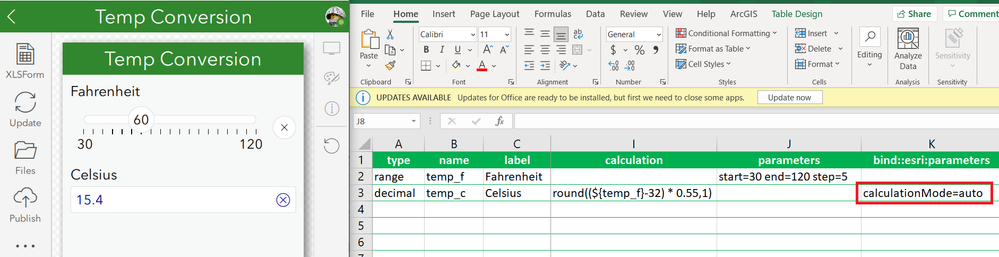

If you want to set the calculation mode explicitly, go into the bind::esri:parameters column, and add calculationMode=auto, as shown in the next screenshot.
The auto calculation mode is supported in both the field and web apps.

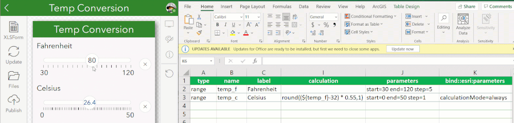

Set the calculationMode to always, and your calculation will never be suspended. It will run always, no exceptions. If the user manually resets the calculated value, as soon as any referenced variable in the calculation changes, the expression will be evaluated.The calculation will also be triggered when the form is submitted, just in case!

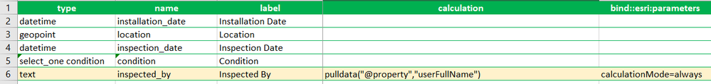

I find calculationMode=always particularly useful when working with the Inbox. Lets take the example in the screenshot below: Row 6 is using calculationMode=always because we want its value to be always calculated, even if the record is opened in edit mode.
In the example above, if you keep the calculationMode as auto, the inspected_by value would remain unchanged if you open the record from the Inbox.
