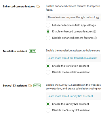

These capabilities are disabled by default and only enabled when an organization administrator has opted in. To enable these features, organization administrators need to:
  1.  Navigate to the AI assistants section on the ArcGIS Online organization settings page and turn on the Allow use of AI assistants by members of your organization option.
  2. Go to the Survey123 website, open the Organization -> Settings tab, and under the Extensions section turn on the Survey123 assistant and Translation assistant.

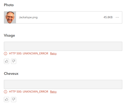

PierreloupDucroix
Hello, currently the photo extractor AI assistant is returning HTTP 500: UNKNOWN_ERROR when trying to process an image, any idea ?

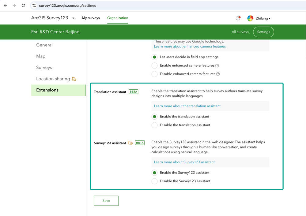

@LouisaM ,
Can you please confirm that your Survey123 organization settings are as below? If yes, can you share a screenshot of the Design tab on the website?
ZhifangWang
@PierreloupDucroix ,
Does the same error occur consistently? If you see it again, could you submit feedback using the thumbs up/down icon so we can investigate?
PierreloupDucroix
@ZhifangWangit occurs every time and I tested multiple photos.
And yes I enabled AI settings
PierreloupDucroix
I just sent a thumb feedback
PierreloupDucroix
Hello @ZhifangWang , FYI it is now working, I needed to enable AI assistant also in my AGOL organization parameters

LouisaM
@ZhifangWang it worked thank you
