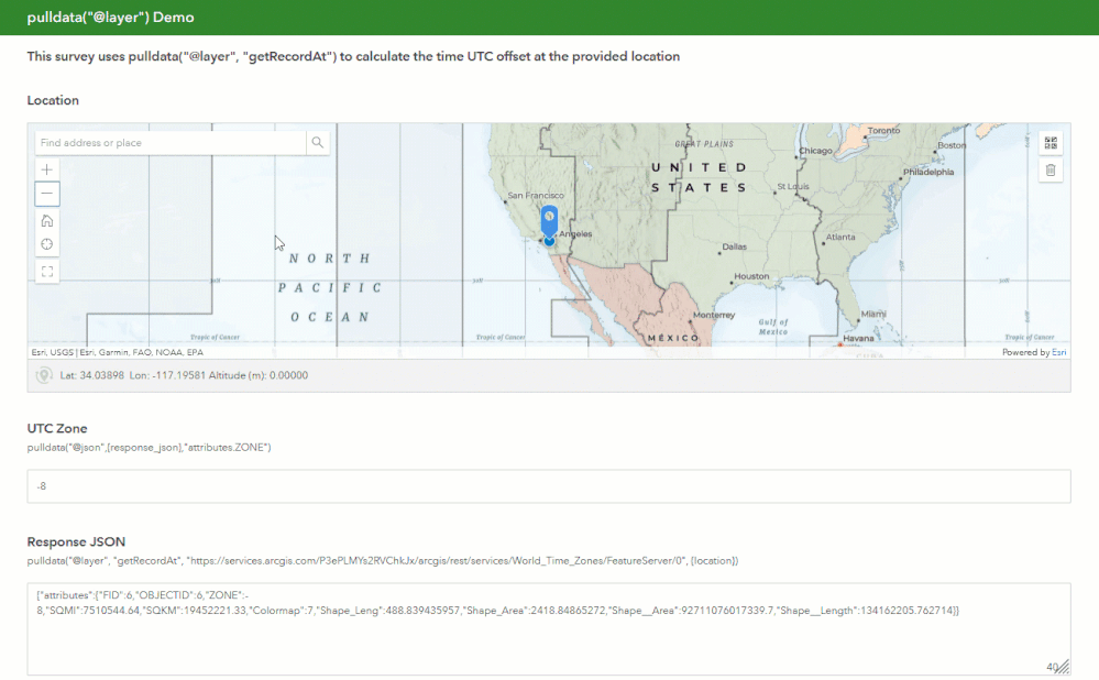

Here is a live example showing how you can use a point-in-polygon query to calculate a value.
The new pulldata("@layer","getRecordAt") function allows you to query a layer without the need for custom JS codeThe new pulldata("@layer","getRecordAt") function allows you to query a layer without the need for custom JS code

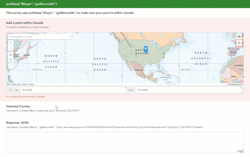

Here is another live example showing how you can you use pulldata("@layer") to make sure the user adds a point within a particular polygon.
You can use pulldata("@layer") in constraints. For example, to prevent users from submitting locations outside of your area of interestYou can use pulldata("@layer") in constraints. For example, to prevent users from submitting locations outside of your area of interest
