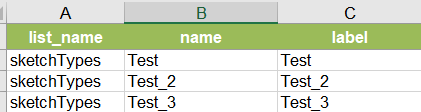

  1. Ensure you have all your images in the media folder.  For simplicity, make sure the extension for all the images is the same. That is, make sure they are either all .png or .jpg.
  2. Create a list in the choices worksheet where the value of the name column for choices in your list matches the name of filenames in the media folder.
  3. Set the expression in the calculation column of your draw or annotate question as:
concat(${ChoiceQuestion},'.png')
In the example above, I assume that your choice question is a select_one type of question named ChoiceQuestion. I also assume that your images are in .png format. Remember that all the concat() function does is to concatenate the value of the selected choice in your select_one question, with the .png extension.

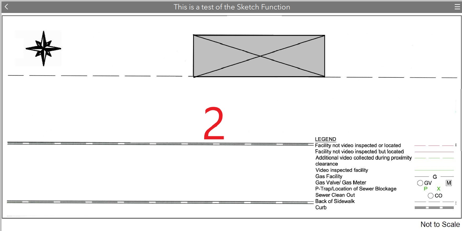

I'm using Survey123's Smart Sketch function in my survey to create field sketches on an inspection form. Currently I'm having the user select a particular condition in a select_one and use that in the calculation field of my image as a way to select a custom canvas. This suites my need perfectly, but I'm finding the actual drawing tools to be somewhat limited.
Is there any way to set custom symbols in the Smart Sketch drawing tools? I'd like to be able mirror the legend in the example.

JamesTedrick
Esri Esteemed Contributor
Hi Kristopher,
It is not possible to set a custom set of symbology for the annotating the image.
