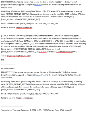

I've developed a Survey with 784 fields. When running the script, I get the following error.
I've tested the survey using fewer fields. The script runs with 599 fields but crashes with anything greater. Does anyone know a work around for this? I need to include all 784 fields for this survey. Any help would be greatly appreciated! Thanks!
