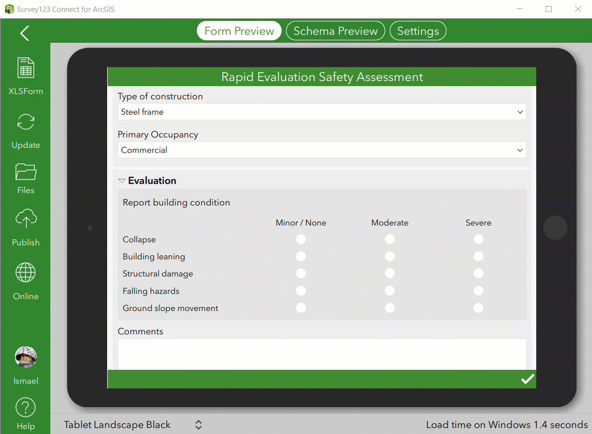

Single choice grid in the field app
We introduced single choice grid in the Survey123 web designer and the web app at version 2.8. We are now expanding support to Survey123 Connect and the field app. Single choice grid allows you to compact series of choice list questions, reducing the need for end-users to scroll up and down the form. They can also help you make your forms more easily readable. The key to using single choice grid is a sequence of more than 2 or 3 questions sharing the same list choices. In XLSForm jargon: A sequence of select_one questions sharing the choice list. This new appearance is ideal when you plan on using forms with a tablet, although keeping labels short and choices limited can give you good results even in smart-phones.
In the next animation you can see a single choice grid compacting a set of 5 building condition questions. Note how the choices are labeled just once for the entire set.
In XLSForm, you can add a single choice grid by simply enclosing your select questions within a group and setting the appearance of the group to table-list.
typenamelabelappearance
begin groupassessment_groupReport building conditiontable-list
select_one evaluationassess_collapseCollapse
select_one evaluationassess_leaningBuilding leaning
select_one evaluationassess_structuralStructural damage
select_one evaluationassess_fall_hazFalling hazards
select_one evaluationassess_group_movGround slope movement
end group
Please note that groups using the table-list appearance will take the whole width of the form when your form uses the theme-grid style.

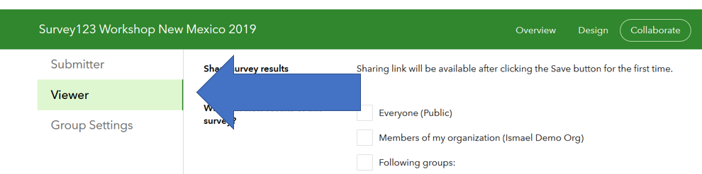

  • Go into the Collaborate tab in the Survey123 website and share your survey results (Viewer tab) as appropriate.
  • Build a URL setting the mode parameter to view, and pass the objectid of the record you want to display.
https://survey123.arcgis.com/share/1cb28b212b5542acbbdbaa35feba0765?mode=view&objectId=10

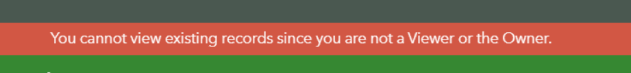

If you get an error like shown below, make sure  you share your survey results through Collaborate as described in step 1 above.

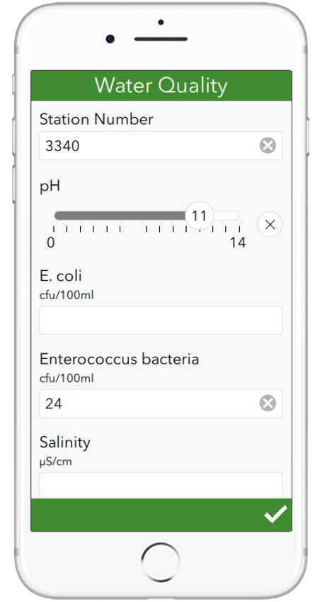

Range question
The range question is designed to restrict integer or decimal user input to a well defined range. If you setup your survey on top of an existing feature layer, range questions are a perfect fit for fields with a range geodatabase domain. Range questions display in your form as a horizontal slider, ideal for touch screens, although when the control has the focus you can also change its values using the left and right arrow keys.
In the screenshot on the right, you can see a range question being used to help users document pH values on a water sample. Values can be easily set between the pH range of 0 (acidic) and 14 (alkaline).
Through the XLSForm spec, you can dictate different aspects of the slider such as the minimum and maximum accepted values and the colors of the control. Like other XLSForm questions, you can apply calculations, data validation constraints, default values, etc.
Check out the Range help topic for more details.

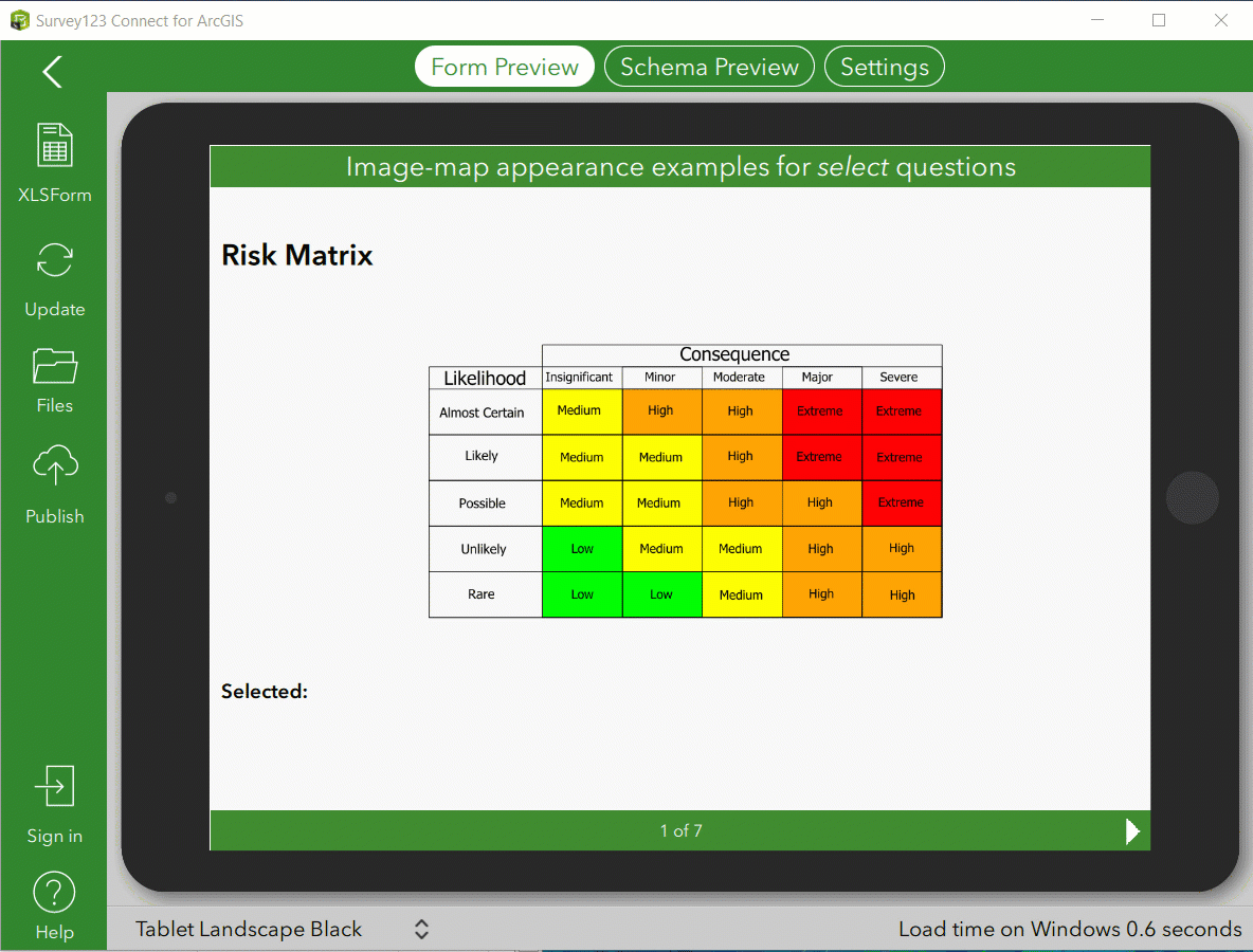

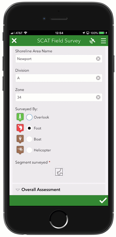

Pictorial lists
There are a few common ways to represent a list of choices: a drop-down list, horizontally, vertically... etc. Carefully choosing the best style for a list, is important. A horizontal arrangement is a good choice for short lists, reducing the need for users to scroll the form up and down. Vertical lists present options in a very clean way, but if you have many choices, a drop-down list will save users time, particularly if you enable auto-complete.
There are some cases, where a pictorial representation of a list is by far the best option. Brett Stokes‌ put together a nice collection of examples, which you can see in the animation below. In all these examples, making selections over the images comes more naturally than making the selection over a traditional list of choices. It is more intuitive, can be less prone to errors and quicker for the user to make their selection.
To learn about including selectable images in your smart form, refer to the https://community.esri.com/groups/survey123/blog/2019/09/26/using-the-image-map-appearance-in-survey...  post by Brett. Well worth a read!

DanielKonzek
I can't seem to get the single choice grid to work on a survey with multiple pages (groups with appearance type 'field-list').  I added a group within page 3 of my survey and configured the subsequent questions to be a single choice grid, and the questions don't appear at all in the survey.  When I remove the 'field-list' appearance from my survey making it all one page, the single choice grid works great.  Can you have a 'table-list' group within a 'field-list' group?
Thank you!  Dan
BlytheSpendlove2
Really great updates! I'm eager to implement some of this new functionality like the single choice grids and pictorial list options!
DougBrowning
MVP Esteemed Contributor
Do you have the style set to theme-grid pages?  (and not just theme-grid)
Also be aware that when you go to grid the entire form goes grid.  So you have to set sizes everywhere.  The easiest way is just set to w1 then all questions get their own line.
DanielKonzek
Hi Doug,
  I don't have grid set at all.  I didn't think these question types require a grid theme?  The single choice grid works properly when I remove my 5 page breaks (field-list appearance) and just have a survey with 1 page.
Thank you,
Dan

Hi Dan,
Unfortunately, there is a limitation in working with the single choice grid and pages - both use the 'field-list' appearance  (for the single choice grid, it's behind the scenes).

I love the idea of the single choice grid but can't get it to work. I don't have any styles set and am not using field-list. I have a bunch of yes/no select one questions so I started a new group, and in the line of "begin group" I added "table-list" to the appearance. I added a row for each question, then end group - I still don't get the single choice grid format - what am I missing?
MikailaBell
I'm implementing single choice grid on a new form, which is a checklist style form. It's a perfect fit.
One question comes up. When my list of questions is long, sometimes the user needs to scroll past where the options are visible at the top. In excel, you can set the view to always include that top pane with your column labels. Is there something like that formatting available? That is, I want my select_one choice labels to be visible, not just the radio buttons, for questions that are lower down on my table-list.
Please let me know if I am missing something. Thanks in advance, and still love it, regardless of how this turns out.

Hi Dena,
Just to check, the rows in the group are select_one questions, correct? It should look something like:

Hi Mikaila,
Thanks for the feedback- you are correct that if the list of questions is longer than the screen, you can't see the labels for some questions.  As a workaround, you could break up the question into blocks to ensure the header is visible- in most situations we've seen, it's often the case that questions can be grouped into sub-blocks based on what they are asking.
