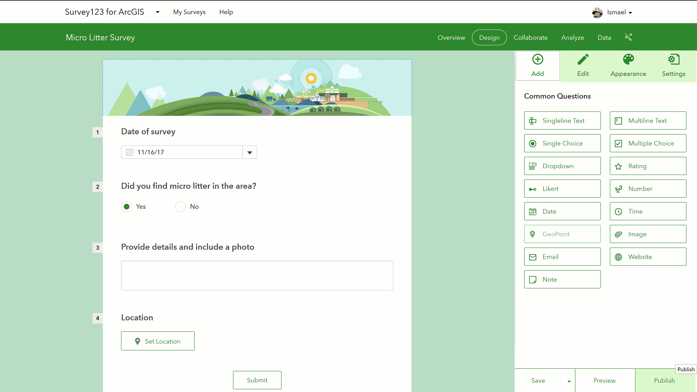

Survey Publishing Enhancements (Modify Schema)
With Survey123 web designer, you can visually create surveys right from your web browser.  Our vision with web designer is to provide the simplest experience possible for building powerful smart forms.  Survey123 web designer, in fact, does a lot for you under the covers including automatically building a fully functional ArcGIS feature service where data from your survey will get persisted.  Up until this release, you could not control the exact characteristics of the fields in your feature service. This is not typically an issue except when you want to download the data to Microsoft Excel, CSV or other formats like Shapefiles.
Starting with this release, we added an option in the Publish Survey dialog that lets you modify the schema of your survey's feature service.  You can control the exact name that will be given to fields, define the values to be stored when using choice lists and even the maximum length of text fields.
Please note that you will not be able to change  the schema of fields that already exist in your feature service.  For  example, when you publish your survey for the first time, you will be able to modify the schema for all questions in your survey. However, if you publish the same survey again, you will only be able to modify the schema for new questions in your survey.

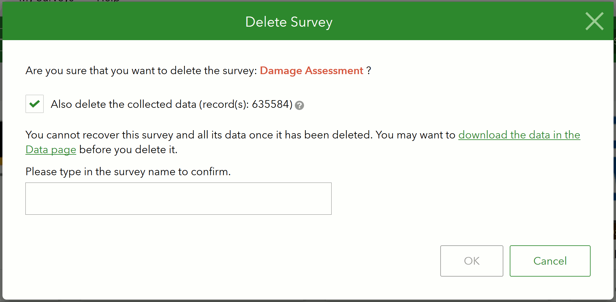

Delete a survey while preserving the data
Starting with this release, the Delete Survey dialog in the Survey123 website includes a handy option that will let you optionally preserve all data you captured.   If you choose to delete all collected data, your survey will be removed along with its feature service.  If you choose this option, you may want to first make a backup copy of your data first.

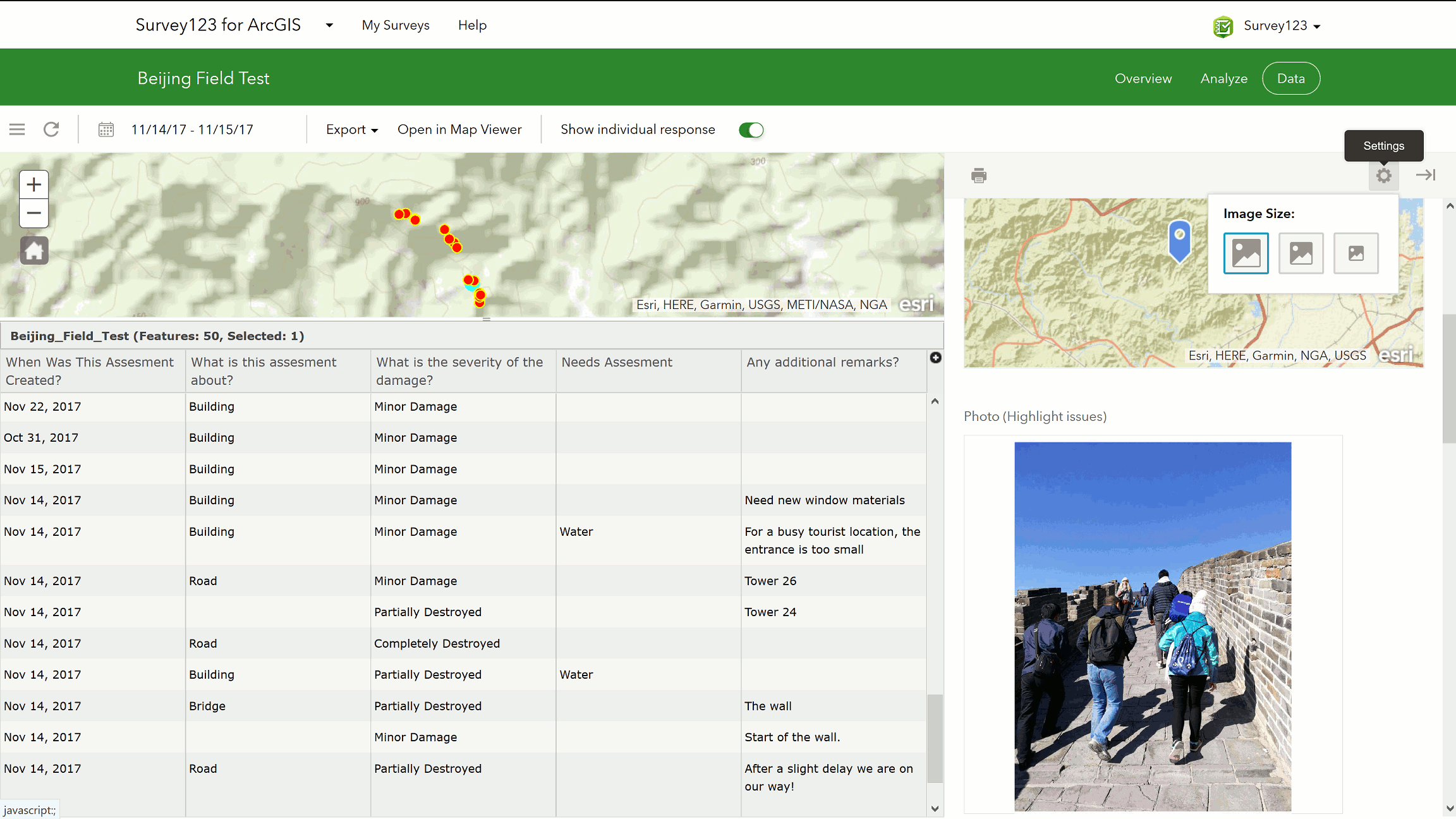

Changes to the Data tab
The Data tab in the Survey123 website lets you explore all collected data using a map, a table and an individual response format. We made a handful of changes:
  • A new refresh button lets you more easily update the map and table to get the latest data from your survey.
  • You can now more easily drag the table view over the map to split the screen in between the two views.
  • The Individual Response view includes a new settings dialog from which you can control the size of photos retrieved into your report.
  • Click on photos in the Individual Response reports to open a detailed view which will let you also see EXIF metadata, if available, including location, direction, camera and size.

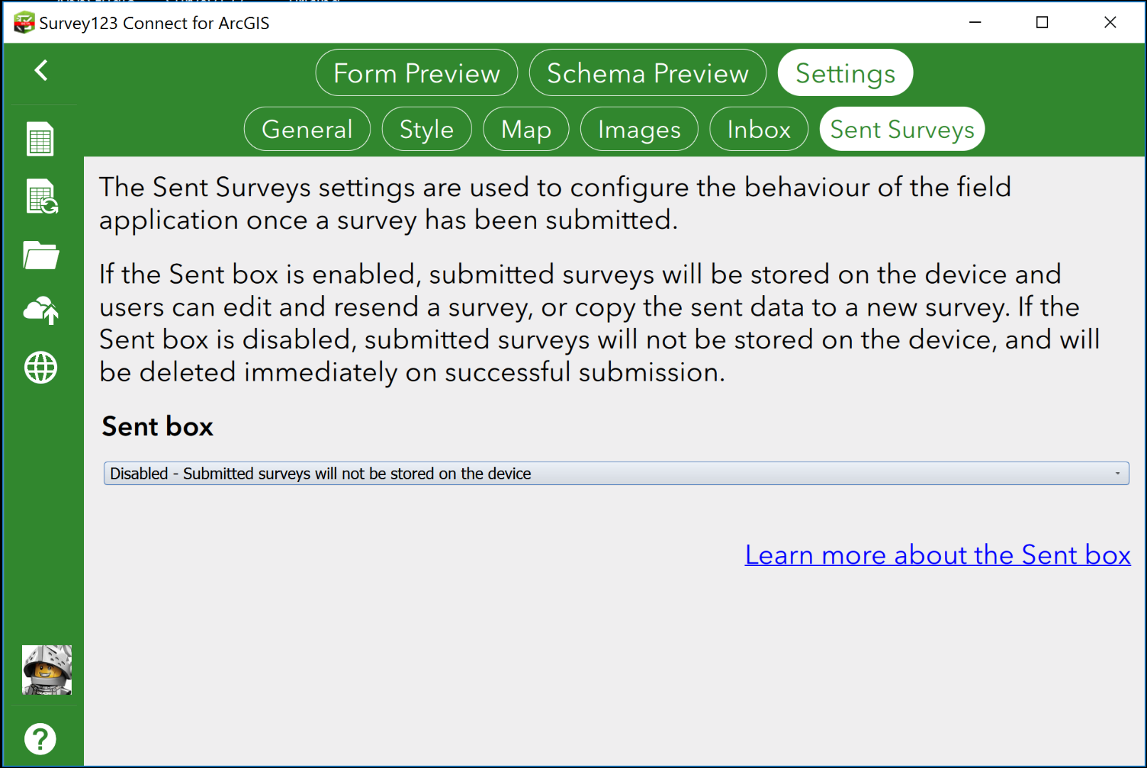

Disable the Sent box in the Survey123 field app
Through a new survey-level setting in Survey123 Connect for ArcGIS you can now disable the Sent box in the Survey123 field app. This setting has been requested by a handful of organizations who, for security reasons, want to ensure that data already submitted to ArcGIS is completely erased from the device.  Disabling the Sent boxis also handy if you want to prevent users from copying previously sent surveys to create new ones.
If you already have published a survey and you want to apply this setting, field users will need to delete their local copy of their survey first, and then download the survey again.  Simply refreshing the survey from the Download page will not take effect, unless the Sent box in the device is already empty.
For more info, check this help topic.

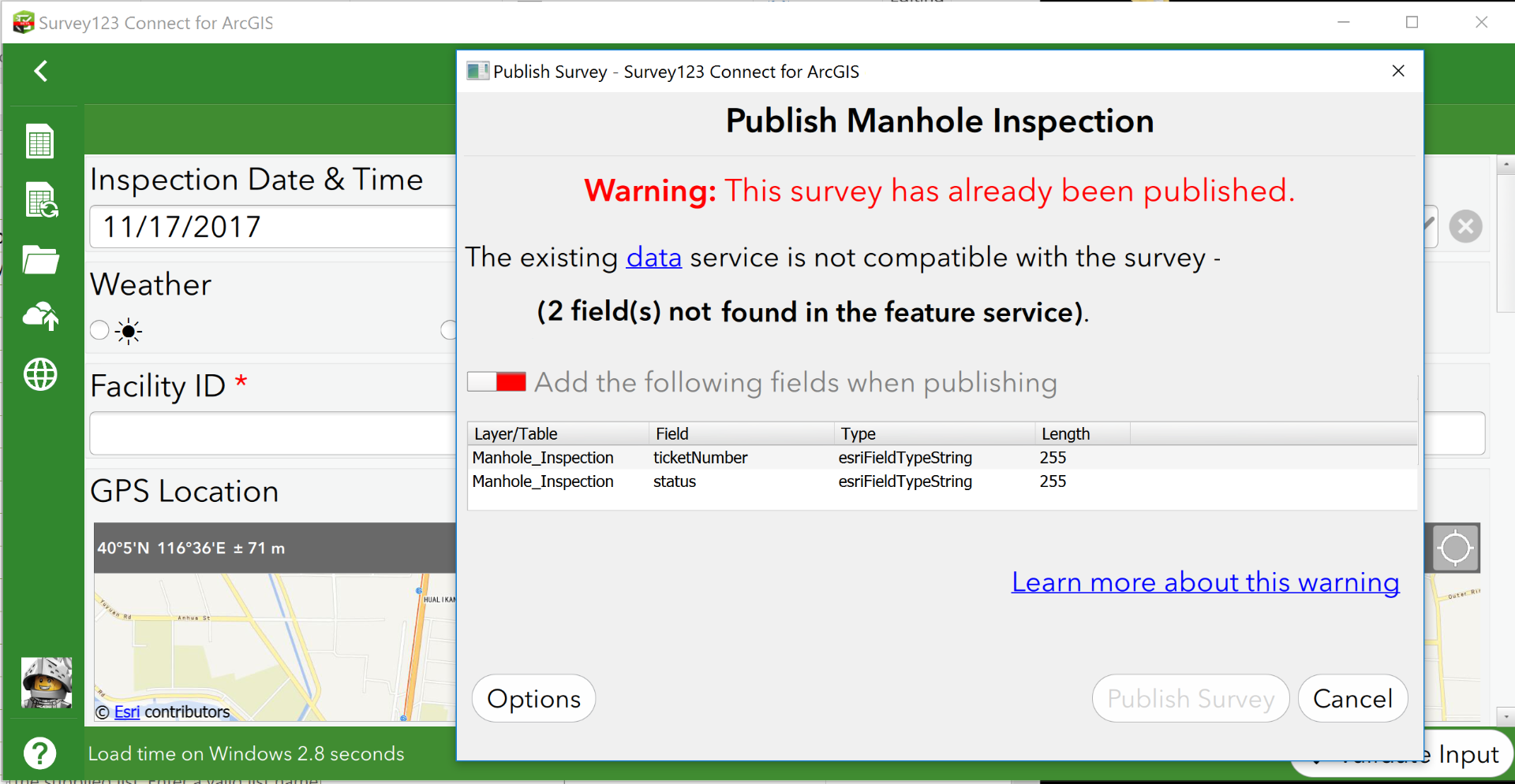

Survey123 Connect publishing enhancements
Survey123 Connect will no longer overwrite your survey feature service when attempting to add new questions to an already published survey.  A new dialog will prompt you to confirm that new fields should be added to your feature service.
A side effect of this enhancement may cause you some confusion when attempting to re-publish surveys with notes in your XLSForm.   If the Publish dialog indicates that new fields will be added for your note questions, simply go back to your XLSForm and remove the value of your note question in the name field of the survey worksheet.  Notes should not include a name! You can learn more about notes in https://community.esri.com/groups/survey123/blog/2017/11/14/understanding-notes-in-survey123

GaryBowles1
What is the default setting in Survey123 Connect for the Disable Sent Items Box?
--gary
BrandonArmstrong
Gary,
The 'Sent box' is set to be Enabled by default.  In order to disable the Sent box, you need to apply the change in the Settings > Sent Surveys options within Survey123 Connect prior to publishing your survey.  It is explained in further detail, here...
Learn more about the Sent box

Does the "disable sent box" also work in the browser app? We want to use this to prevent users sending duplicate surveys.
JamesTedrick
Esri Esteemed Contributor
Hi Niels,
There isn't an equivalent concept of the Sent Box in the web form's context.  In the web designer, you can specify that a submitter is allowed or not allowed to send a second survey.
