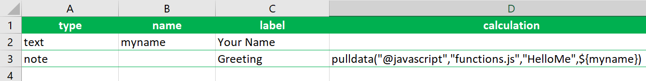

Using regular XLSForm syntax, we could calculate the greeting as follows:
concat("Hello ", ${myname})
This already teaches us something: custom JavaScript functions are not always the best approach. If you can solve something easily using pure XLSForm functions, do not use a custom JavaScript function. In our case, we will use this example only because it helps us focus on the basics of setting up a custom JavaScript function.
To invoke a JavaScript function from XLSForm, we use the puldata() function. For example:
pulldata("@javascript","myFunctions.js","HelloMe",${myname})
The parameters for the pulldata() function are as follows. First we pass "@javascript" to indicate that we want to execute a JS function. Then, we pass the name of the JavaScript file that contains our function, which in this example is "myFunctions.js". The next parameter is the name of the function within the file that we want to call: "HelloMe". Lastly, we pass as many parameters as the JS function takes. In our case, we will just pass the name of the survey taker, which is contained in the ${myname} question. If the JS function takes more parameters, we would add them in our pulldata() function call as more parameters separated by commas.

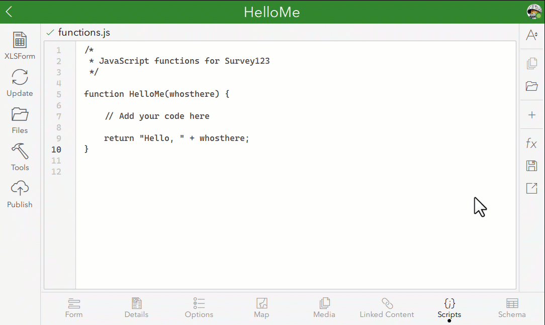

For the pulldata() function above to work, we need to create a "myFunctions.js" file with its corresponding "HelloMe" JavaScript function. In fact, as you refresh your survey preview in Connect you will get a File not found: myFunctions.js error. That is totally expected.
Custom JavaScript files are stored in the survey directory, within a folder called scripts. In the old days, you had to create the folder manually and add your JavaScript files to it. Starting with version 3.12, you will see a Scripts tab at the bottom of Survey123 Connect that will help you with the process as shown in the next animation:
Next, you can add your own JavaScript function (or functions) to the file. For example:
function HelloMe(whosthere) {
    return "Hello, " + whosthere;
Do not forget to click the Save button on the bar in the right side!
You can test and even copy the pulldata() function to invoke your function right from the Scripts tab.

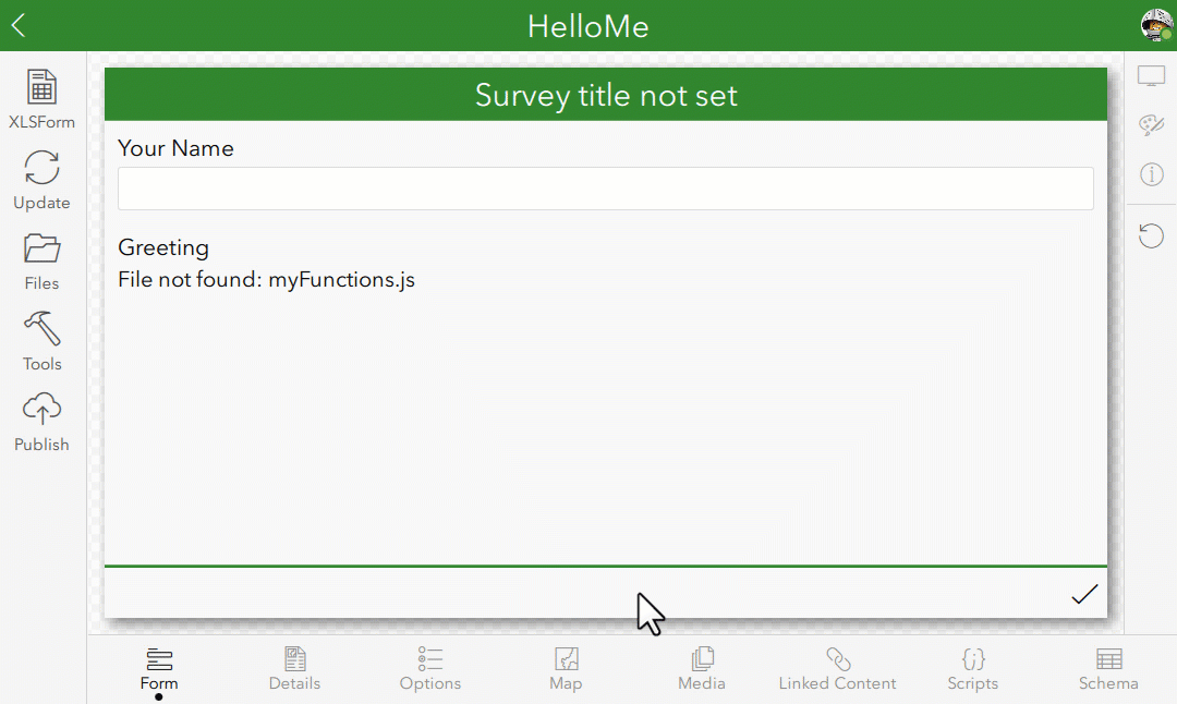

Naturally, you will find a few bumps before you get your JavaScript functions working. Here are some of the most common errors that you will encounter:
File not found: myFunctions.jsYour pulldata() function is trying to load a JavaScript file that cannot be found in the scripts folder
Error in myFunctions.js : 6:16 Expected token `;'Syntax error in line 6 of your function.
@javascript error:TypeError: Property 'HelloMe' of object [object Object] is not a function in myFunctions.js:HelloMeYour pulldata() function is trying to invoke a function that cannot be found in the JS file you specified.

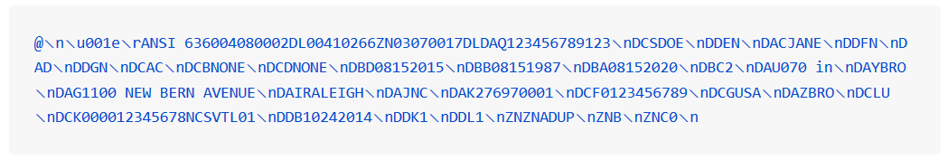

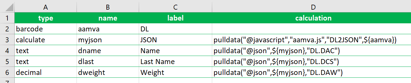

As an example, let's take the contents of an AAMVA PDF417 barcode. This type of barcode is used in driver licenses and encodes information such as name, birthday and many other things. Since the Survey123 field app has built-in barcode capabilities, you can scan such a barcode. The contents would look something like this:
AAMVA
This JavaScript function formats the AAMVA string from a driver's license into a JSON object, which can then easily be used within XLSForm to extract the specific information you are looking for:

This is what the actual XLSForm would look like. Note that the myjson question uses pulldata("@javascript") to first convert the output from the barcode question into a JSON string. Then the pulldata("@json") function is used to extract specific attributes from the string.
Tip: Set the value of bind::esri:fieldType to null in the myjson question if you do not want to store the aamva raw string in your feature layer, but still be able to process it within your form logic.

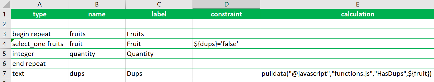

Passing a question within a repeat to pulldata("@javascript")
When you pass a question within a repeat to pulldata("@javascript"), the JavaScript function receives an array of values for the specified question. For example, lets say we want to display a warning message if the user has introduced duplicate values in a question within a repeat. In this case, we want to create a JavaScript function that takes an array and returns true if duplicate values are found. Something like this:
function HasDups (myArray)
 return new Set(myArray).size !== myArray.length;
Now all we need to do is to call the function and pass the question within the repeat to it:
When passing a question within a repeat to pulldata("@javascript"), it is important to keep the pulldata("@javascript") outside the repeat. In the example above, note that I first keep the result of the duplicates check outside the repeat, and then I use that value in the constraint expression for the fruit question.

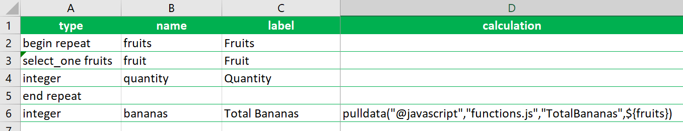

Passing a repeat to pulldata("@javascript")
You can also pass an entire repeat to pulldata("@javascript"). In this case, your JavaScript function will receive all records within the repeat as an array. Each item in the array is in turn another array representing the values for that record.
In our fruits example above, let's pretend we want to calculate how many bananas have been entered. If we pass the entire fruits repeat, we can use a JavaScript function to loop through every record. If the fruit in the record is banana, then we get the quantity value and add it to our total.
function TotalBananas (fruitsrepeat)
 var totalBananas = 0;
 var i;
 for (i = 0; i < fruitsrepeat.length; i++) {
  if (fruitsrepeat[i].fruit=='banana') {
     totalBananas = totalBananas + fruitsrepeat[i].quantity;
 return totalBananas;
Here is the XLSForm:

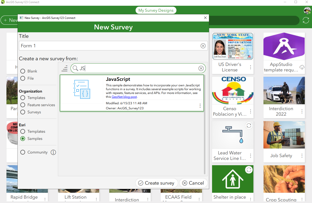

Survey123 Connect includes a new XLSForm sample illustrating how to use custom JavaScript functions in multiple scenarios. As you get hands-on, this is a sample worth checking.

yaserkhouja
I am trying to read the driver's license barcode, PDF417 code.

Is the Total Bananas example presented in the original post working for others?
Is this blog spot being monitored anymore by @IsmaelChivite ?
BEGIN ORIGINAL COMMENT:
I am having trouble implementing the arrayname.fieldname syntax shown above. Finally, I copied both the xlsx and js code directly from the totalBananas example above and it does not run successfully: totalBananas remains 0. Is this a limitation of Connect v3.11.123?
I added a text flag to ensure that the script is actually running. After I enter one record into the repeat, e.g. 'Banana' and quantity 3, my flag changes to True but the totalBananas remains 0. I've copied and pasted the value "banana" from my script to my choice list value to ensure no typos. Here's the (unformatted) code:
function getRepeats (fruits)
var i;
var txt = 'False';
if (Array.isArray(fruits) && fruits.length>1){
txt = "True";
for (i = 0; i < fruits.length; i++) {
if (fruits.fruit=='banana') {
totalBananas = totalBananas + fruits.quantity;
txt = txt + ", " + totalBananas.toString();
return txt;
Example Result: True, 0
Thank you!

I am running into the same issue with the Total Bananas example as noted above by @wOwen using version 3.12.232.  Wondering if @IsmaelChivite has any updates or suggestions to get it to work?
DataOfficer
@EricFord3 @wOwen it doesn't work for me either.

@DataOfficer  @EricFord3  @wOwen : I went bananas with the bananas example. It is fixed now. When you create your fruits list, make sure the values in the name column are lowercase.

DataOfficer
Hi @IsmaelChivite ,
I've just tested your updated bananas script but it's still not working for me.
My setup is as follows:
Script (myFunctions.js)
function totalBananas (fruitsrepeat)
 var i;
 for (i = 0; i < fruitsrepeat[i].length; i++) {
XLSForm - survey
typenamelabelcalculation
begin repeatfruitsFruits
select_one fruitnamefruitFruit
integerquantityQuantity
end repeat
integerTotalBananasTotal Bananaspulldata("@javascript","myFunctions.js","totalBananas",${fruits})
XLSForm - choices
list_namenamelabel
fruitnamebananabanana
fruitnameappleapple
I have also tried renaming the repeat 'fruits' to 'fruitsrepeat' but the number of bananas is still not calculated.
IsmaelChivite
Esri Notable Contributor
@DataOfficerRemove  [i] from line 5 so it looks like this
DataOfficer
Thanks @IsmaelChivite. That works
