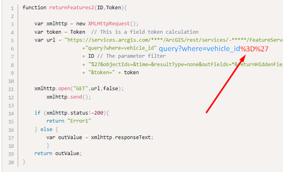

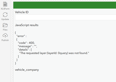

anonymous55
Hello @Jesan90
I have this code but I am getting error of Token.
Basically, I want user type scooter ID and get some information from survey for example vehicle_company or etc.
function returnFeatures2(ID,Token){
    var xmlhttp = new XMLHttpRequest();
    var token = Token  // This is a field token calculation
    var url = "https://services.arcgis.com/****/ArcGIS/rest/services/-*****/FeatureServer/0"
					+"query?where=vehicle_id"
					+ ID // The parameter filter

anonymous55
Hello all
I have these so have and I am getting this error:
JS Code
    var url = "https://services.arcgis.com/*****/ArcGIS/rest/services/******/FeatureServer/0"
					+"query?where=vehicle_id%3D%27"
					+ "%27&objectIds=&time=&resultType=none&outFields=*&returnHiddenFields=false&returnIdsOnly=false&returnUniqueIdsOnly=false&returnCountOnly=false&returnDistinctValues=false&cacheHint=false&orderByFields=&groupByFieldsForStatistics=&outStatistics=&having=&resultOffset=&resultRecordCount=&sqlFormat=none&f=pjson"
				    + "&token=" + token
    xmlhttp.open("GET",url,false);
        xmlhttp.send();
    if (xmlhttp.status!=200){
        return "Error1"
    } else {
        var outValue = xmlhttp.responseText;
	return outValue;
Xlsx Form
Jesan90
Hi @anonymous55
Try this:
Jeffry J,
