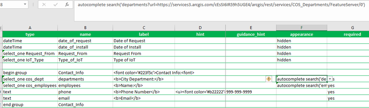

@IsmaelChivite Is there a way to populate a dropdown of a field in the survey by pulling a field data in a map/feature service or a linked csv file? Thanks
KimberlyMcCallum
Hi @HelenZhou! I'm not sure how to do this with JavaScript but that would be very interesting... Another approach would be to use the search() in the appearance field as described here: https://community.esri.com/t5/arcgis-survey123-blog/dynamic-choice-lists-using-search-appearance/ba-...
You can reference a feature service or table and can add filter parameters... it's quite slick but be warned, that it seems to have some problems when utilized within repeats.

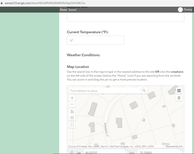

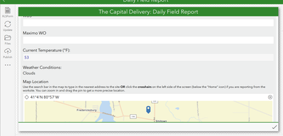

HelenZhou
I am using the javascript function to calculate some values from a publicly accessible arcgis feature service. It looks like, the javascript function only works when logged in with an arcgis online account. For public anonymous survey, it doesn't work. Doe anybody have the same experience?

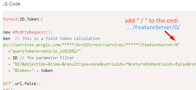

Hello @Jesan90
I have this code but I am getting error of Token.
Basically, I want user type scooter ID and get some information from survey for example vehicle_company or etc.
function returnFeatures2(ID,Token){
    var xmlhttp = new XMLHttpRequest();
    var token = Token  // This is a field token calculation
    var url = "https://services.arcgis.com/****/ArcGIS/rest/services/-*****/FeatureServer/0"

anonymous55
Hello all
I have these so have and I am getting this error:
JS Code
    var url = "https://services.arcgis.com/*****/ArcGIS/rest/services/******/FeatureServer/0"
					+"query?where=vehicle_id%3D%27"
					+ ID // The parameter filter
					+ "%27&objectIds=&time=&resultType=none&outFields=*&returnHiddenFields=false&returnIdsOnly=false&returnUniqueIdsOnly=false&returnCountOnly=false&returnDistinctValues=false&cacheHint=false&orderByFields=&groupByFieldsForStatistics=&outStatistics=&having=&resultOffset=&resultRecordCount=&sqlFormat=none&f=pjson"
				    + "&token=" + token
    xmlhttp.open("GET",url,false);
        xmlhttp.send();
    if (xmlhttp.status!=200){
        return "Error1"
    } else {
        var outValue = xmlhttp.responseText;
	return outValue;
Xlsx Form
Jesan90
Hi @anonymous55
Try this:
Jeffry J,

PJ
Hi @IsmaelChivite,
I am using pulldata function (pulldata("@json", ${jsonresponse}, "weather[0].main") ) to pull weather data from https://home.openweathermap.org/.
I plugged the weatherkey code (32 characters) into the default field in the Survey123 form to pull weather data. Its working fine in survey123 app but its not working on Survey123 website. I changed the survey from Public survey to private, still no luck.
I will appreciate if you could help me.
Here are the screen shots
PJ_1-1649172622954.pngPJ_1-1649172622954.pngPJ_2-1649172690126.pngPJ_2-1649172690126.png
Thanks

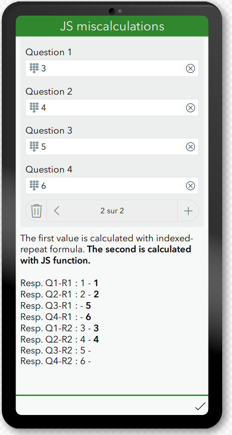

JudithLandry
Hi @IsmaelChivite,
Since the last release, repeats in JS functions don’t behave as Arrays anymore. In the example below, you can see that the value of each question differs depending on how you calculate them.
Questions 1 and 2 have the same results for both calculations but 3 and 4 have wrong calculations when using JS. Since questions 3 and 4 are unanswered in the first repeat, we should have “undefined” as values. Instead, the values of the second repeat are shifted to the questions of the first repeat.
Will this behavior be the norm from now on?
JamesTedrick
Esri Esteemed Contributor
Hi @JudithLandry -
Apologies for the delay, we just noticed this comment.  I think I see the issue you are describing - to confirm, this is not when you are passing the entire repeat set into a function, but you are passing a field within the repeat into the function - undefined values are being stripped from the set of values?
JudithLandry
HI @JamesTedrick ,
Yes, for a given question, undefined value is replaced by the value of the next repeat (same question) if there is, and it gives no answers (blank) in the second repeat.
I didn’t check if this issue was corrected in the lastest release.
