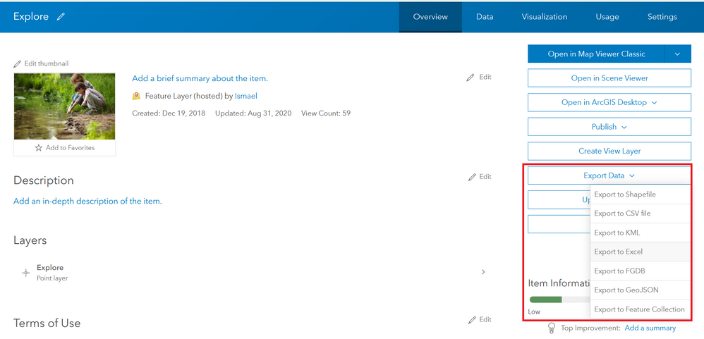

Manually downloading your data from ArcGIS
  1. Log into your ArcGIS organization and go to Content.
  2. For every survey you have published, you will find a folder and within it, a Feature Layer. Open the details page of the Feature Layer and select Export Data.

DougBrowning
MVP Esteemed Contributor
Yes just go to the item page for the feature service and click Export Data (this is what the script simulates).
If you do not see this button then go to Setting for the item and check Allow others to Export different formats.
