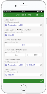

Basic Types and Appearances
The Basic Types and Appearances section of the survey sample explores the different ways in which a date or time question can be presented to the end user. Combinations of the question type and its corresponding appearances, will help you control the best user input style that fits the needs of your workflow.
The first question in this survey is of type date and it uses no appearance. A calendar control is shown for users to pick a date.  Note that the question shows the current date by default. This is accomplished by setting the default column in the XLSForm to today().
The following 3 questions illustrate the use of appearances: Year, Month-Year and Week-Number.
  • Week-Number is the most exotic. Week numbers are often used in government and business for fiscal years and timekeeping. With this appearance, the calendar widgets will let the user pick a date and display the week number in the form.  You will also see the week numbers on the side as you select the date. The week numbers are calculated following the ISO-8601 standard.
  • The Year and Year-Month appearances are handy when you simply want to present the user with a choice to pick a year, or a year-month.
As you exercise the calendar control, it may not be obvious, but you can actually tap and hold the arrows to quickly navigate back and forth in time.
Survey123
  • The DateTime and Time questions are shown at the end of this first section. Note that the questions automatically show the current date and time. This is accomplished by adding he now() function into the default column.

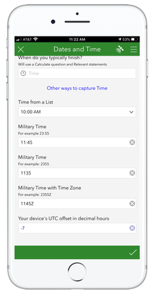

Other ways to capture Time
The last section in the sample survey shows other techniques to capture time.
  • The 'Time from a list' example should not come as a surprise. A select_one type of question with minimal appearance is a nice way to present a list of hours to choose from.
  • Then there are some other examples illustrating how to use regular expressions in constraints as well as input masks.  I will go into the details here, so nothing is missed.
    • First, an example to capture military type with a period. For example: 11:35.  Note the use of an input mask here. The input mask automatically adds the period (:), so the user does not have to worry about that. The value of the input mask is 99:99 meaning that we expect to digits followed by a period and two more digits. You will see that the constraint column checks to make sure that the hours do not go beyond 23 and the minutes do not go beyond 59.  Note: input masks are NOT supported in the Survey123 web app.
    • In the second example, we want to capture military time, but without the period. For example: 1135. In this case, I want to highlight a couple of things. First, note that I am not using an input mask like before. It is not needed, because we can set the type of question as integer (to ensure that only numbers can be typed) and also set the the maximum length of the field to 4. This is done through the bind::esri:fieldLength column. This will do two things: will ensure that only integers with 4 digits can be entered into the Feature Service, and most importantly, will limit the user input in the Survey, to 4 numbers.  I still added a regular expression in the constraint to ensure that proper values within the 24 hour day are entered.
    • In the third example, I want to capture military time including the time zone. For example 1445Z. Z is the time zone (ZULU, which represents UTC). In 1445G, G is for Golf and represents UTC + 7.  That would be 1445 Golf Time. How awesome is that! More details on this crazy business with Time Zone Abbreviations here. Again in this case I added a mask and complemented it with a regular expression in the Constraint.
