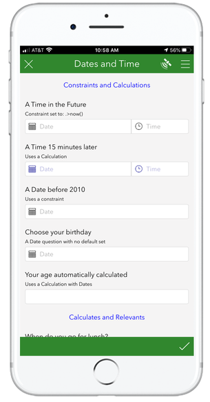

Constraints and Calculations
This section of the sample survey will be useful to understand how you use formulas with dates and date-times, so you can validate user input, as well as pre-compute date values. The questions in the survey are self-explanatory, The best is that you have a look at the XLSFile to better understand how things are done.
  • Constraints: A common constraint you will want to enforce is one that ensures a date is in the past or the future. That is pretty straight-forward: .> now() will ensure the user input is in the future for example. If you want to reference another question in the survey, you can use something like this: ${birthdate}<today(). This will ensure that the birthday question has a value in the past.
In constraints you may be asked to ensure a value is always newer and older than a fixed date. The date function is very useful in these cases. For example, you can set a constraint such as . > date('2006-01-01') or ${manufacture_date} > date('2006-01-01').
If you need to work with time constraints, simply add the time component to the date() function using the ISO 8601 notation.

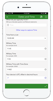

Other ways to capture Time
The last section in the sample survey shows other techniques to capture time.
  • The 'Time from a list' example should not come as a surprise. A select_one type of question with minimal appearance is a nice way to present a list of hours to choose from.
  • Then there are some other examples illustrating how to use regular expressions in constraints as well as input masks.  I will go into the details here, so nothing is missed.
    • First, an example to capture military type with a period. For example: 11:35.  Note the use of an input mask here. The input mask automatically adds the period (:), so the user does not have to worry about that. The value of the input mask is 99:99 meaning that we expect to digits followed by a period and two more digits. You will see that the constraint column checks to make sure that the hours do not go beyond 23 and the minutes do not go beyond 59.  Note: input masks are NOT supported in the Survey123 web app.
    • In the second example, we want to capture military time, but without the period. For example: 1135. In this case, I want to highlight a couple of things. First, note that I am not using an input mask like before. It is not needed, because we can set the type of question as integer (to ensure that only numbers can be typed) and also set the the maximum length of the field to 4. This is done through the bind::esri:fieldLength column. This will do two things: will ensure that only integers with 4 digits can be entered into the Feature Service, and most importantly, will limit the user input in the Survey, to 4 numbers.  I still added a regular expression in the constraint to ensure that proper values within the 24 hour day are entered.
    • In the third example, I want to capture military time including the time zone. For example 1445Z. Z is the time zone (ZULU, which represents UTC). In 1445G, G is for Golf and represents UTC + 7.  That would be 1445 Golf Time. How awesome is that! More details on this crazy business with Time Zone Abbreviations here. Again in this case I added a mask and complemented it with a regular expression in the Constraint.

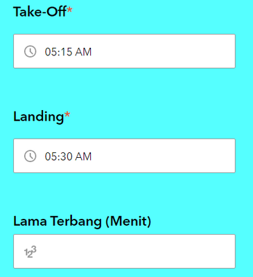

LuthfiAnggaraAtmaguita
Hi, I have an issue with the time calculation. What's the correct expression to get the time difference in minutes? (landing-takeoff=Lama Terbang)
I tried some expressions and it seemed working perfectly in the form preview in Survey123 Connect. However, after publishing it, "Lama Terbang" question won't calculate it automatically in web. One of expression I used: int((decimal-date-time(${landing_time}) - decimal-date-time(${take_off_time})) * 24*60)
What type of question that can accommodate the time calculation? Is it integers? or decimal?
Another issue is in the form preview Survey123 Connect shows 24H time format, after publishing it it changed to AM-PM format. Actually it's not a big deal, as long as I can still do calculation between 2 different time.
Thanks!

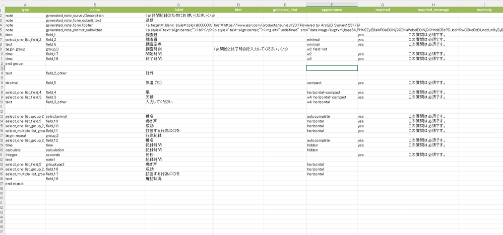

FRSadmin
Hello,
I have posted my own questions to no success and have looked around on other boards (with responses) and have still not found a solution to my issue.
I do not care what the end result has to be, how can I use now() to record the time up to seconds and have it displayed in a repeat (but also editable in case they choose a new repeat item too quickly).
We are recording bird calls and need to know what time they chirp, hoot, etc.. so ideally this would function much like a stop watch where everytime I enter a new repeat it logs that time stamp.
I don`t know if there is a way to do this very initial bird call without editing the time stamp but I am at my wits end at trying to have seconds natively display in anything (even a text format question) using the now() function.
LiamHarrington-Missin
Hi @FRSadmin,
What an interesting use case.  Does it have to be Survey123 for this?  Your use case suggests that QuickCapture might give your users a better experience, at least for the logging of bird calls?
That being said it doesn't allow for the need to edit the time stamp easily if you hit the button by mistake.  I guess my question would be how common this would be and whether you can just accept a small percentage of errors in an otherwise good dataset?  QuickCapture might be a way to reduce the number of spurious records as a result of a better user interface.
It's pretty simple to launch QC from within S123 as well so you could do the bulk data entry in S123 (e.g. survey metadata) and then use a hyperlink to launch QC to capture the bird calls that are clearly time critical.  Not knowing your workflow means I'm speculating about the content of your survey.
L.
FRSadmin
@LiamHarrington-Missin
I have never really used Quick Capture so I would have to look into this, does all the data get recorded in the excel file that survey123 would output?
We are trying to digitalize our wildlife surveys using PowerAutomate and right now Esri`s connector for survey123 is our best bet at lightening the out-of-office and in-office workload.
If all the base data can be pre-established and QuickCapture was launched afterwards...
From what I was shown these bird call surveys are usually for one species at a time, but alongside each time entry there is the possibility for some adjustments such as what type of call it was or if it was male / female.
What is the code in survey123 connect to pair the two if you don`t mind me asking?
I attached the form, but I am in a Japanese company so I don`t consider the titles to make much sense.Bird_Call.PNG

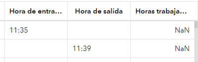

JavierCMartínezPrieto
Greetings to all,
I have problems to make a calculation with the time, the problem is the following:
I have made a survey where the clockings of the workers are contemplated and I need to calculate the time of hours that are working, that is to say the subtraction between the hour of exit and the hour of entry, this operation is very simple when the record of the hour is in the same row, that is to say it is when in the survey we mark entries and we save it without sending and for the exit we edit the survey and we send it, but the operation that they want is not that but a survey is sent for the clocking in and another survey is sent for the clocking out, this causes that in the same row only has the clocking in or clocking out, causing that the working hours account does not work (clocking out - clocking in).
I am interested in doing it in a dashboard graph, more specifically in a table, I think the solution would be an arcade script but I can't do it.
any help is appreciated.
P.S: I attach an image to clarify the issue of the values in the rows.
Greetings Javier

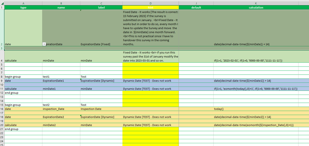

PanGIS
Hello @IsmaelChivite and @JamesTedrick ,
sorry for tagging you but I am desperate. 😓
I need to find a way to calculate a date that is always next month, always on the same day of the month,  (let's say the 15th of the following month).
if I submit the survey today, the calculated date is the 15th of February.
If I submit on any day in February, that calculated day will be the 15th of March.
I found a way to calculate it but I need to change the date every month and this in not going to be possible.
My attempts, the first works but I have to change it manually every month, the other two are failed attempts:
https://www.dropbox.com/s/54kfbvtvg9i942q/test_Date.xlsx?dl=0
IsmaelChivite
Esri Notable Contributor
@PanGIS
I hope you can use a custom JS function. This seemed to me like the most straight-forward approach.
function setNext15(inputDate) {
 var inputDate = new Date(inputDate);
 var inputMonth = inputDate.getMonth();
 inputDate.setDate(15);
 inputDate.setMonth(inputMonth + 1);
 return inputDate;

PanGIS
Hi @IsmaelChivite  it works! ❤️
I believe there shouldn't be any issue as the survey is internal within the Organization and it requires login.
The lack of internet is not listed as limitation, so it can be saved in the Outbox without problems!
Thank you!!!
