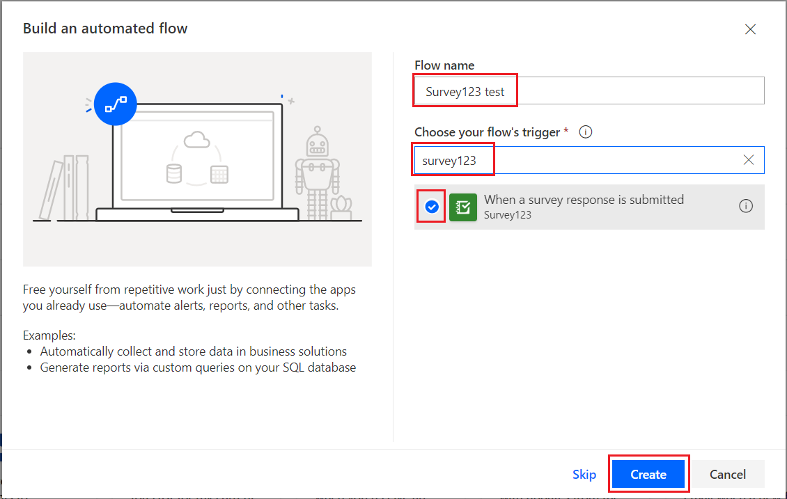

1.  Open Power Automate (go to your O365 account and search for the app), go to My flows and click on + New > Automated - from blank :
2.  Give your webhook a meaningful name, so you know which one to edit/disable later if needed when you have more of them.
3.  Search for ‘Survey123’ under Choose your flow’s trigger, select When survey response is submitted and log in to your AGOL account (you only need to log in once, the connection is stored in your Flow profile). No alt text provided for this image

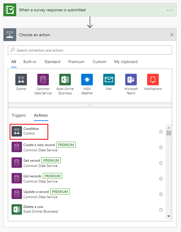

5.  Choose an action: for example Condition

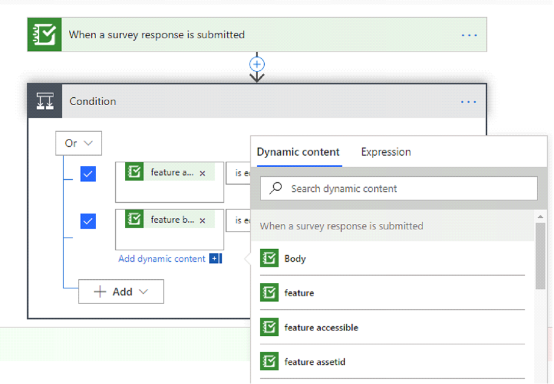

and add your survey field(s) and the value(s) you want the webhook to be triggered for. You can select your survey fields from the Dynamic content part for the condition:

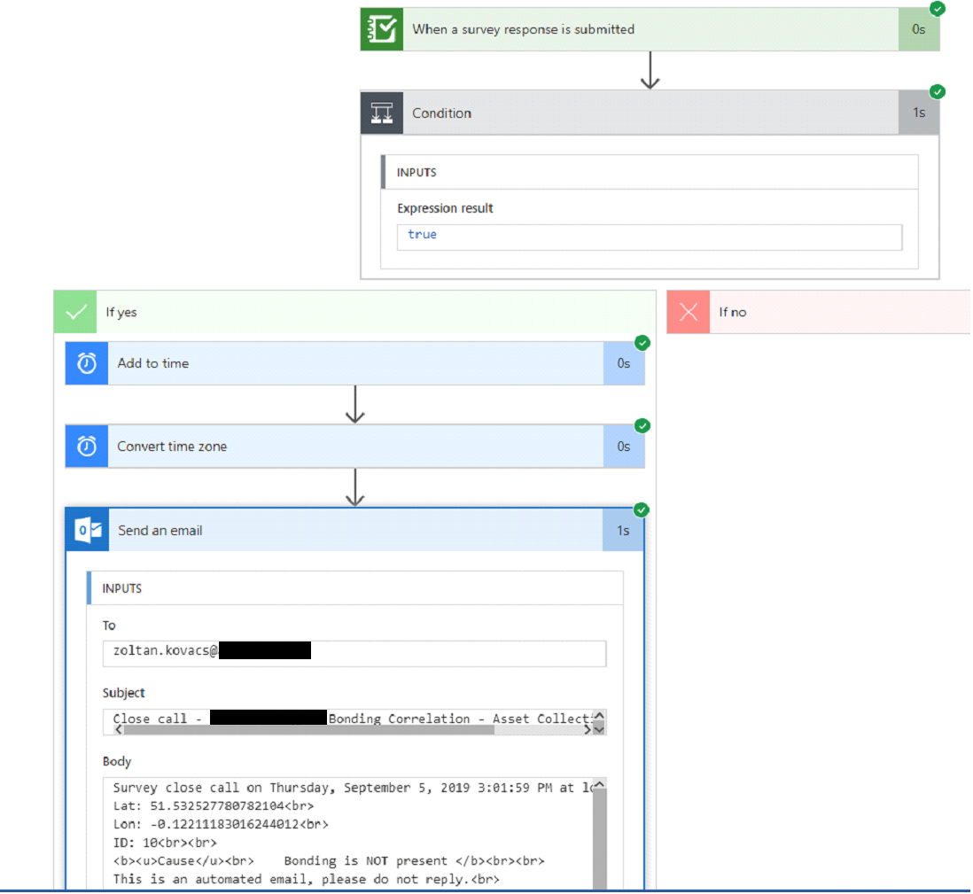

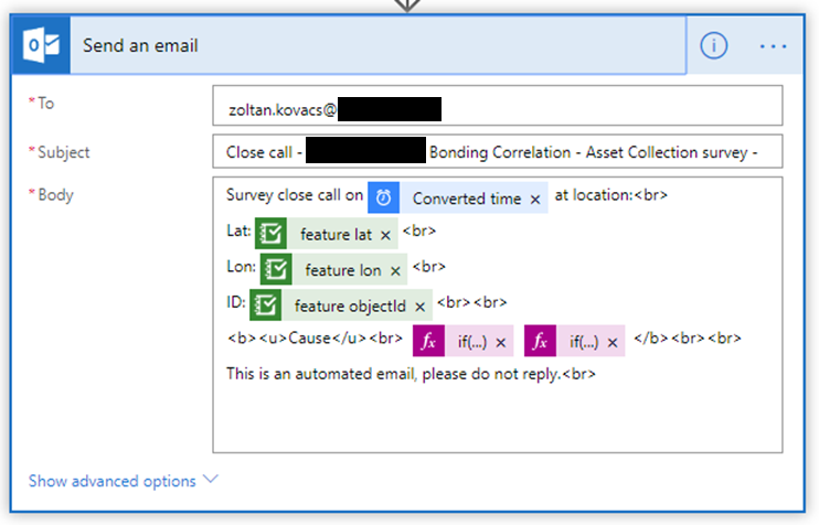

Under the If yes branch, add a new step (click on the ‘+’ sign) and search for Send an email (Outlook). Set up the required details and save your flow – use both Save buttons: one at the bottom and one in the top right corner!

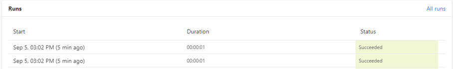

You should be able to see the webhook triggered on the webhook’s page under Runs
If you click on an item on the list, you can see the details of that run. You can use this to see if a run failed (and why). No alt text provided for this image
