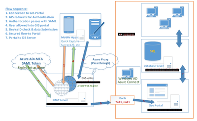

Aneel_Kumar_M
Dear Philip,
We are using ArcGIS Portal, DMZ server, MS Intunes and then using mobile application "Survey123" Please see below work flow diagram.
In this case, do I need to modify application properties in MS Intune ? and also in App Studio?
One more thing, when we change Azure proxy other than "pass-through", survey123 is not able to connect the portal site from the mobile application. it is connecting only with "pass-through" option.
Please advise, thanks in advance.
