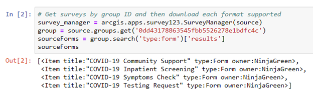

To start, we are going to need two GIS connections; one to our “source” organization, which is the organization in which the survey and content currently resides that we would like to clone; and another to a “target” organization, which is the organization that we would like to clone the survey and content to.
In our first example we are going to highlight a workflow where we have a few surveys shared to a group that we would like to clone to a different organization. In order to work with our surveys a Survey Manager is defined. A survey in the Survey Manager is a single instance of a survey project that contains the item information, properties, and provides access to the underlying survey dataset. Please use this link for more information on working with the Survey Manager. In this example, four surveys are shared to a group. Using the group ID, a connection is made to the group and a list is created containing all form items within the group.
Now that we have our forms as a list, we are ready to clone the content from our source organization to the target organization. As previously noted, a use case for using the clone_items() method is to clone surveys between development, staging, and production organizations. This first example clones the surveys from our existing group (as defined above) located in the source organization to the target organization and shares the cloned surveys to a group with the same name in the target organization.

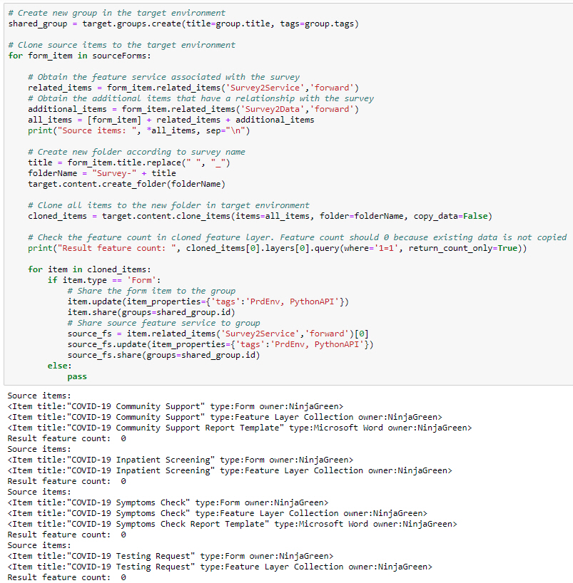

Clone related items:
The code below starts by creating a new group in the target organization using the same title and tags as the existing group in the source organization. Once the surveys are cloned, they will be shared to this newly created group.
Each form item in the source group is looped through, obtaining the feature service associated with the survey through the “Survey2Service” relationship, as well as any additional items related to the survey using the “Survey2Data” relationship. This would include any linked content or report templates associated with the survey. All related items are merged into a list to be cloned. Please review the relationship types documentation for more information on related items in ArcGIS.
Next, a new folder in the target organization is created based on the survey name, and the items in the list are cloned. Since the `copy_data` parameter is set to “False” in the clone_items() method, the resulting services created in the target organization will not contain any data. This is ideal when cloning from a development environment to a staging or production environment, as you might not wish to retain any test data.
Finally, the form items are shared to the group in the target organization that was defined previously, including the feature service, and tags are added to each item.

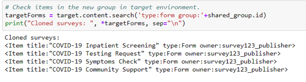

As a confidence check, let’s query the newly created group and confirm our four surveys have been shared.

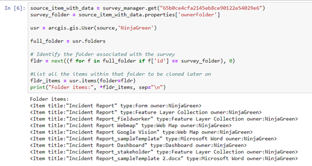

Clone full survey folder:
The code below demonstrates connecting to one specific survey within our organization. Using the properties of the survey, the folder ID where the survey resides is assigned to a variable. Next, all the folders in the source organization for the source username are listed. Using list comprehension, the folder in the `full_folder` variable is matched with the folder ID obtained from the survey properties.
Once the correct folder has been identified the contents of the folder are listed.

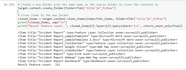

Now that all items to be cloned are in a list, a new folder is created in the target organization to store the content. After the folder is created the content is cloned to the target environment. Since the `copy_data` parameter is not defined the default value for the parameter is “True”, meaning all the underlying data will also be cloned. This means the resulting content in the target organization will be an identical clone of the original data. If you do not wish to retain the source data, setting the `copy_data` parameter to “False” will only clone the data schema and architecture to the target organization. Meaning the survey, web maps, web apps, dashboards etc. will configured as per their original items; the only difference is the feature layer will be empty.
In this blog we’ve covered two use cases of using the clone_items() method. This sample notebook is intended to be used as a guide; you can take what’s here and incorporate it into your own workflows.

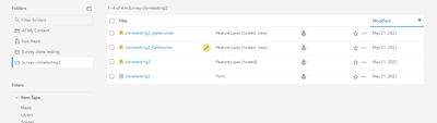

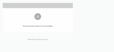

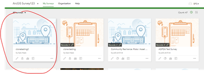

I'm going to insert 4 photos:
  1. Contents of the survey folder in Portal
  2. Contents of the survey folder in Arcgis.com
  3. Cloned survey in Survey123 website
  4. Error when attempting to open cloned survey in Survey123 website
 portal-folder-contents.pngarcgis-folder-contents.pngcloned-survey.pngsurvey123-result.png

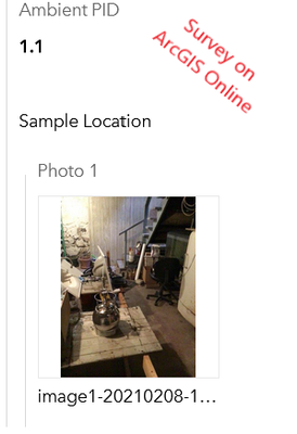

The issue with cloning between ArcGIS Online and Enterprise and vice versa using surveys created in the web has been resolved in the notebook present in the GitHub repo. Please use the latest version of the notebook in the Survey123-tools repo to work around the issue.
gvanderwaal

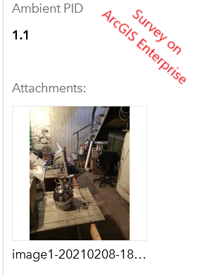

Hi @ZacharySutherby,
I've thrown together a script based on this cloning guide, except using clone_items() instead of copy_items(). Things clone as expected, but images associated with individual survey questions in the source (AGO) lose that association in the target (Enterprise). They're still present in the target feature service, just as "attachments" and do not display when generating reports. Below are screenshots of how they appear through the Survey123 website.
This makes me think there's a relationship not being cloned or restored by Survey2Data or Survey2Service, but these are the only two from the list that show up as active during my testing. What am I missing?
Submissions to the survey post-cloning work as expected - images are associated with survey questions, showing up as expected in reports and in the data.
ZacharySutherby
Hey @gvanderwaal

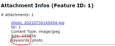

Thank you for reaching out! Survey123 uses keywords to associate what attachment goes with what image question. One thing to confirm is your ArcGIS Enterprise organization will need to be at version 10.8.1 or later as pre-10.8.1 organizations don't support attachment keywords.
If your Enterprise organization is 10.8.1 or later when the data was cloned into the ArcGIS Data Store it may not have brought over the keywords. You can check if the attachment schema has keywords by navigating to the REST endpoint of the feature service in your Ent org, navigate to the layer, append any object ID that you know has attachments, and append /attachments to the URL. It will look something like https://<FQDN>/<webAdaptor>/ArcGIS/rest/services/<serviceName>/FeatureServer/0/<anyOID>/attachments. The page should look like this:
If that Keywords attribute is in your attachment tables schema (like in the photo above) and the value is empty we have a notebook that you can use to automate the process of updating each attachment with their respective keyword. Luckily from the image you shared it looks like the keyword is in the name of the image (in your case image1) and the notebook can extract that and use the name of the image to determine the keyword.
If that Keywords attribute is not in your attachment tables schema (it's missing on the attachment infos page) please download your feature service as a file geodatabase and open the data in ArcGIS Pro. There is a Geoprocessing tool called Upgrade Attachments in Pro that you can use to enable attachment keywords for your attachment table. When the tool finishes please overwrite your feature service and then run the notebook from above to update the attachment keywords.
Please let me know if you would like to schedule a call to discuss this and I would be happy to help out!
Thank you,
Zach
gvanderwaal
@ZacharySutherbyThank you, missing keywords was the issue, I was able to successfully update a keyword manually, and I got the script to work. I appreciate the quick reply!
