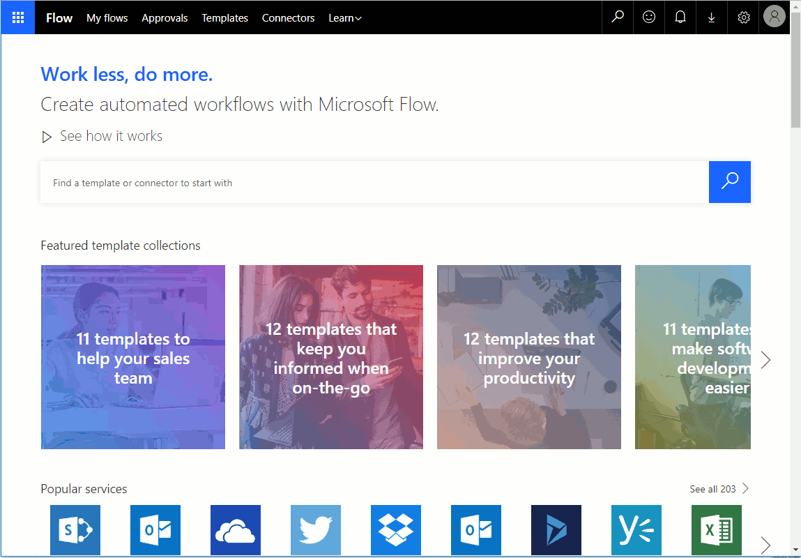

Getting Started with Microsoft Power Automate

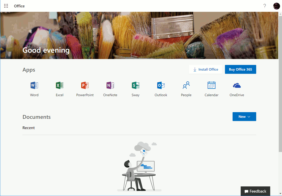

Microsoft Power Automate is included with Office 365. The free version has limited capabilities, but you can upgrade to premium subscriptions. For details check the Microsoft Power Automate pricing page.  You can also create a 90-day free trial.
Unless your subscription to Office 365 already shows Microsoft Power Automate in the main page, you will need to launch it from the Office 365 App Switcher as shown in this animation:
Within Power Automate, go into My flows and select Create from blank. This will present a gallery of Connectors, from which you will be able to trigger your Flow.

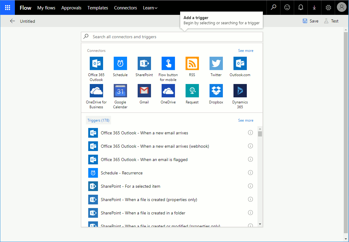

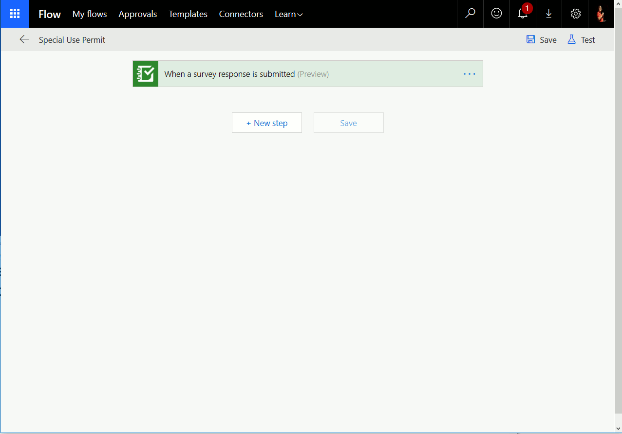

Setting up a Survey123 trigger in your Flow:

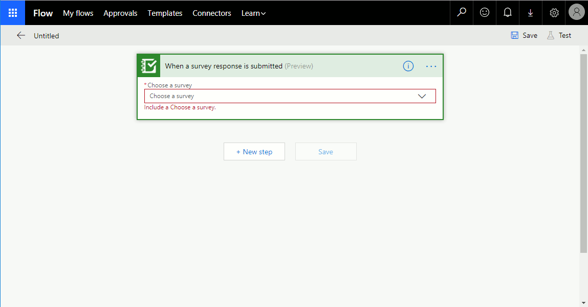

The very first step in every flow you create is to define a trigger. Search for Survey123 in the gallery of connectors. You will notice that Microsoft includes many connectors out of the box. That is the beauty of it!
As you can see, the Survey123 Power Automate connector has only one trigger: When a survey response is submitted.   After selecting the When a survey response is submitted trigger, you will be prompted for your ArcGIS  credentials.   This is because you will need to select among the surveys that you own, the one that will trigger your flow when a record is submitted. Once logged in with your Survey123 credentials, Power Automate will keep your ArcGIS connection for later use.
In my case, I selected the survey called Incident Report.  My Incident Report survey has a few questions such as the location of the incident, a photo, comments and priority, which can be High, Medium or Low.

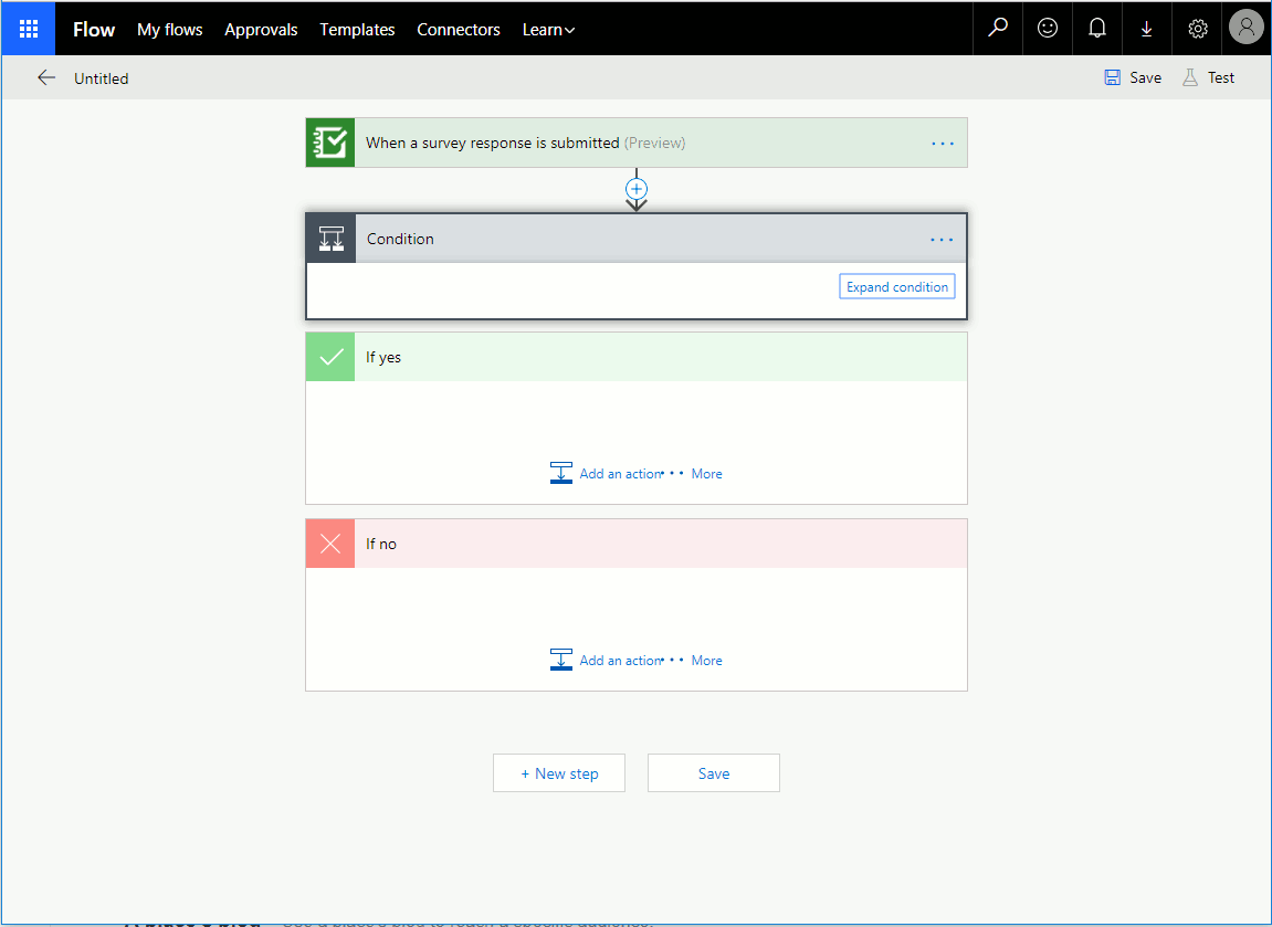

Adding condition logic and actions
Once your survey trigger is set, you can start adding conditions, actions and loop statements to your flow. In this example I will add a condition to check if the value of the Priority question in the survey response is equal to High
The survey data is exposed within Flow, so you can dynamically extract values from the survey submitted and use them in your condition expression.

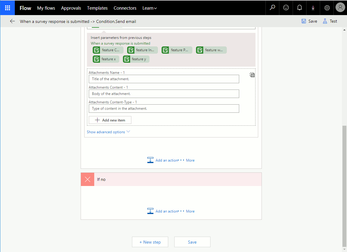

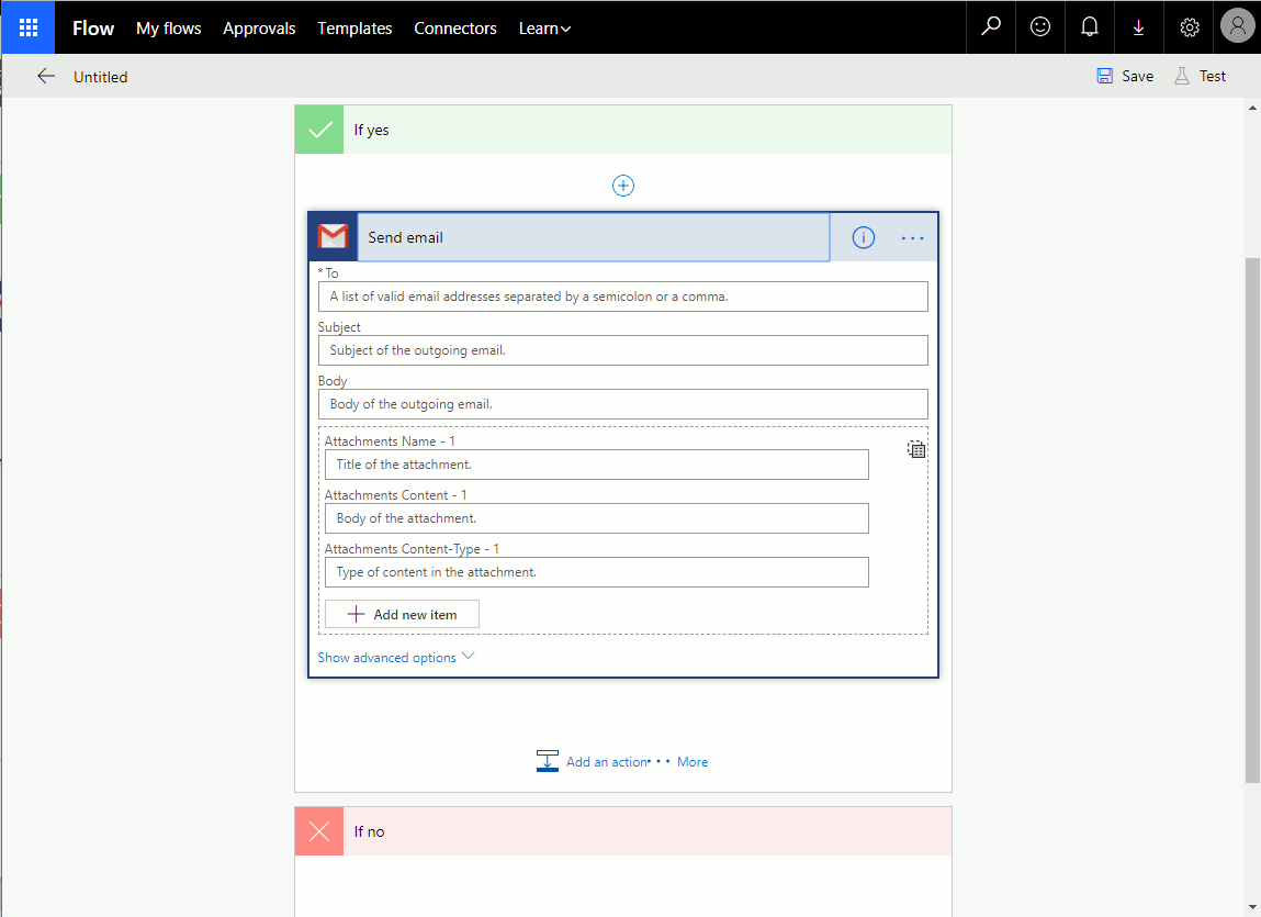

Next, I will add an action in the event that the condition (Priority is equal to High) is true.  I want my action to send an e-mail to someone.  I will choose the Gmail connector, and sign in to grant Microsoft Power Automate permission to use my Gmail account to send e-mails.
E-mail connectors will let you define the recipient, subject, body and attachments in the message.  Again, bringing values from the survey response is possible too when defining actions. Note how in the subject and body of the e-mail for example, you can include values from the submitted data, such as the Date, Priority, Comments etc.  If you get creative, you can do other things such as building a link to a map centered at the Incident's location.
The body of the e-mail is made out of HTML tags. This helps you format your email, by highlighting certain text in bold, or adding breaklines when appropriate. To create a map link illustrating the location of the incident I looked at the ArcGIS  Use URL parameters to modify maps—ArcGIS  Help | ArcGIS help topic. Note how the X and Y coordinates of the submitted incident, can be dynamically added to the link in the e-mail.
In a later section in this blog post I will describe some tips to dynamically get data from your submitted survey.
While you could keep adding additional conditions and actions, I will leave it here, and save the Flow.  I encourage you to explore the many connectors included with Power Automate.

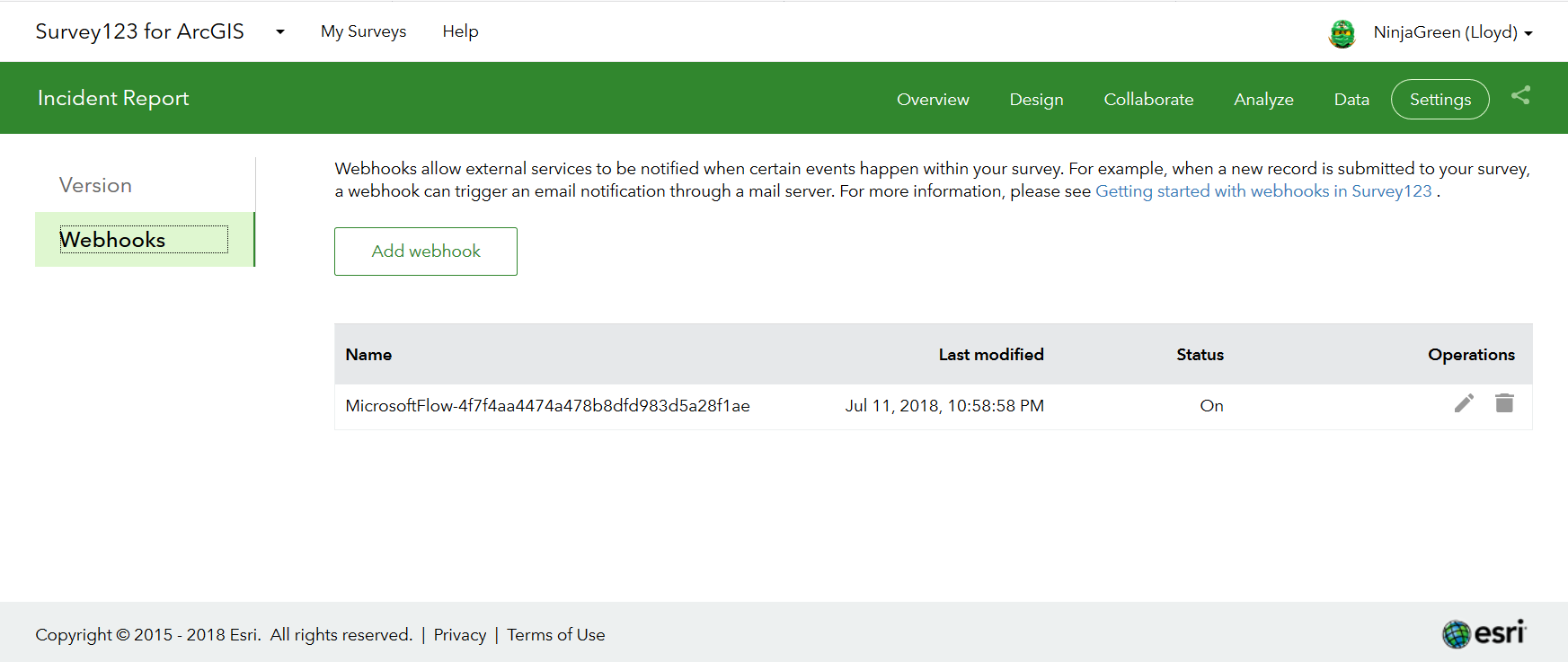

Technically, when you save your Flow, Microsoft Flow registers a webhook in your own survey. Webhooks are the foundation for having Survey123 communicate with Flow to make all the steps described above work.
A webhook is simply a URL Callback. That is, a URL that is invoked by an app when a particular event occurs, to pass some data to another app.  In our case, the apps are Survey123, which invokes the URL, and Microsoft Flow, which is the receiver of the webhook.
In the initial steps described above, when the trigger was setup by selecting the survey, Microsoft Flow created a unique URL representing your Flow. This url was registered as the webhook URL in your own survey when you saved the Flow.
If working with the Survey123 field app, it is important to remember that users will need to download the survey into the app after the webhook URL has been registered.
If you want to look at the webhooks registered in a particular survey, simply follow these steps:
  1. Log into survey123.arcgis.com and select a survey
  2. Switch to the Settings tab of the survey
  3. Open the Webhooks section.
You really do not need to setup webhooks manually when using Power Automate but the webhook dialog can be of interest in case you are working with other Workflow Automation services or with your own custom developed web service end points.
