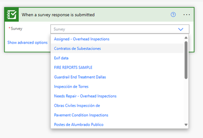

Setting up a Survey123 trigger in your Flow:
The very first step in every flow you create is to define a trigger. Search for Survey123 in the gallery of connectors. You will notice that Microsoft includes many connectors out of the box. That is the beauty of it!
As you can see, the Survey123 Power Automate connector has only one trigger: When a survey response is submitted.   After selecting the When a survey response is submitted trigger, you will be prompted for your ArcGIS  credentials.   This is because you will need to select among the surveys that you own, the one that will trigger your flow when a record is submitted. Once logged in with your Survey123 credentials, Power Automate will keep your ArcGIS connection for later use.
In my case, I selected the survey called Incident Report.  My Incident Report survey has a few questions such as the location of the incident, a photo, comments and priority, which can be High, Medium or Low.

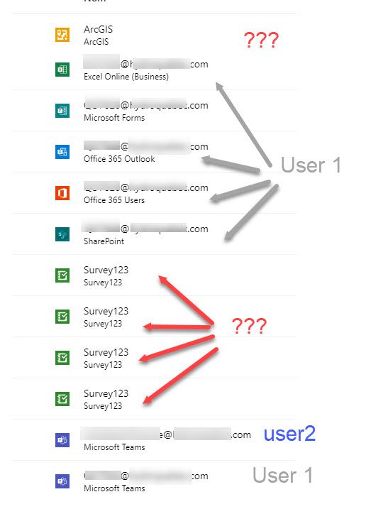

FlorenceRaimbault
Hi @JamesTedrick @IsmaelChivite
When we use Power automate to send info from a survye123 , we Need to  use the AGOL account of the owner of the survey123.
In Power automate usually we know the owner of all the Microsoft's connectors but not for the Survey123, for example I have more than 1 user for the teams connexion ( see image Below).
When we use the Survey123 connector we can't discriminate the owner of the account. In fact, I can't user more the one AGOL account with all Survey123 connector. I try to make a new connection with another account, but the account is still with my name in the detail
Is there a way for ESRI to display the information, and can we use more than one Account for the survey123 connexion?
It's the same for the new ArcGIS connector ;(.
Florence

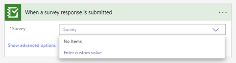

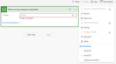

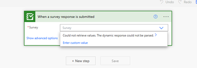

CamrynHill
Hello,
I am currently trying to make a webhook to send me an email for survey submittals and I'm having some trouble. With the creation of the webhook for Survey123, in Make.com, Power Automate.com, and Workflow via Teams they are all having the same problem of not recognizing that I have made a survey. I'm able to connect my account to all of these ways but they are not registering any surveys that have been created. I've also tried adding a new connection for all and it will still not work.
Is there any other way to get this to connect and recognize my previous surveys?
RobertAnderson3
MVP Regular Contributor
@CamrynHill This may be a silly question, but just to make sure, you have PUBLISHED the survey correct?
And for the connection, you are signing into the same account you published the survey to/the one that owns the survey currently?
CamrynHill
@RobertAnderson3 It has been published and it is the same account for both.
Lucas_Halphen
I have the same problem with Power Automate.
Select the 3 dots at the upper right corner, right click.
add (create) a New Connection
Register your credentials.
and you will be able to see the S123 you created.
