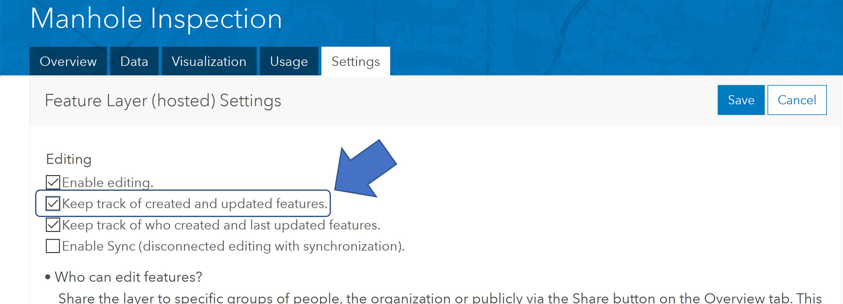

For the script to work you need to enable an option in your survey's feature layer called 'Keep track of created and updated features' .  This is not to be confused  with Editor Tracking.  This option helps the Python script determine if any changes have been made in your feature service.
  1. Login into ArcGIS Online and open the Details page of your survey's feature layer.
  2. Switch to the Settings tab and make sure the 'Keep track of created and updated features' option is checked as shown in the screenshot below.

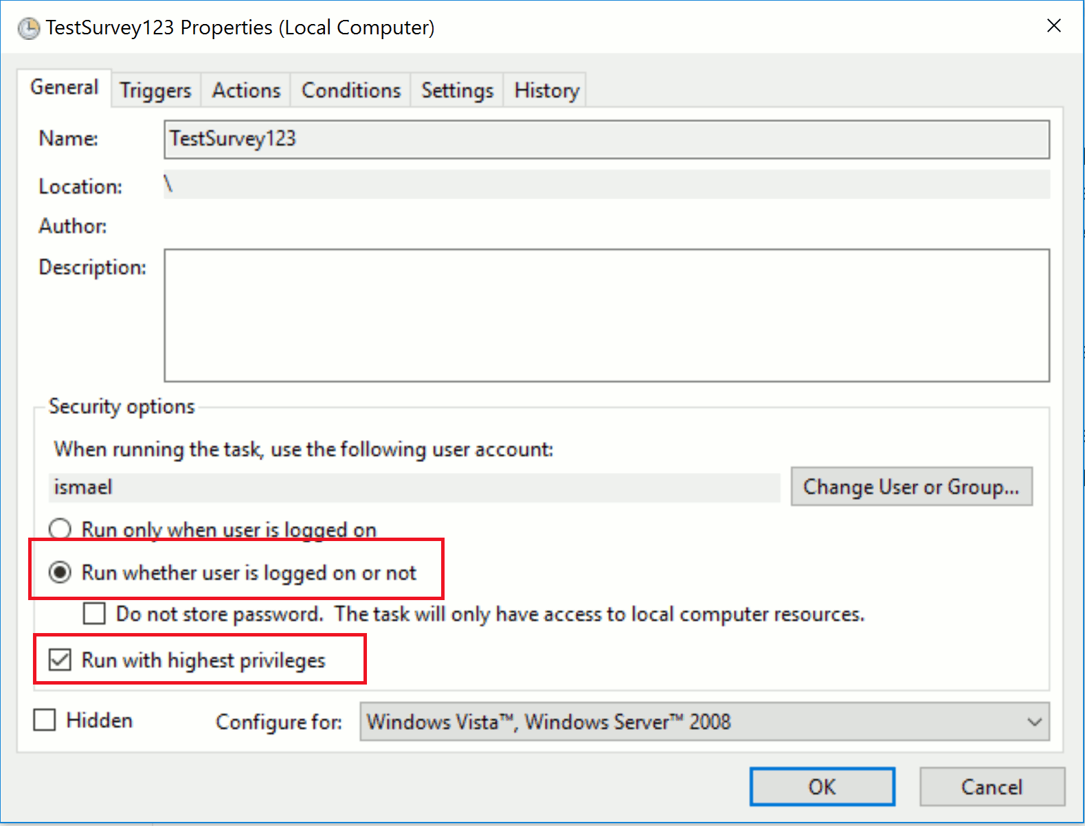

  1. General: Check the option to run with highest privileges and set the task to run even if you are not logged-in.
