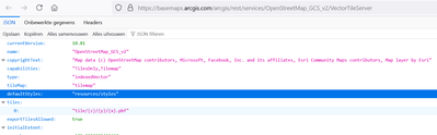

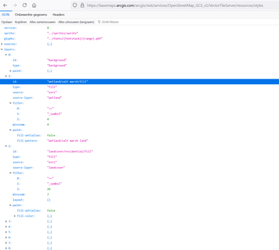

Well, this is getting quite a bit of a hack, but an *.mmpk file is just a ZIP file that you can unzip to an empty (new) folder. If you do that, you should see its contents. ArcGIS Pro project file can be unzipped as well.
There is likely an *.mmap and *.mapx as part of the unzipped file. When I look at a custom created Mobile Map Package for ESRI's OpenStreetMap vector tile service, I see these files containing a reference to the service as Url/uRI, that you can copy and paste in a browser. That shows a JSON service description, that contains a "defaultStyles" reference to the subfolder with styles (in my case resources/styles)
If you subsequently add this subfolder to the Url, it gets you to the JSON style of the service, where you can see the actual layer definitions as JSON items.
Whether all of this gets you anywhere nearer to editing the style of your *.mmpk, IDK..., but at least it should give you some insights as to where it gets it's styling.
MichaelAugust
Yeah thanks, I'm aware of the .zip trick. I'm able to open the json and view it, but what's the workflow to edit and save it for distribution to our Pro users, etc.?
