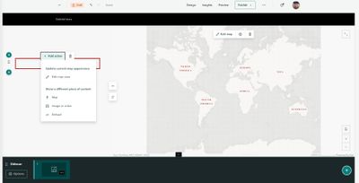

It seems I can no longer use Media Actions to zoom to a location on a sketch map.  i.e, I no longer see the option to "edit map view".  Is this a fact, or has that option been moved or replaced with something else that does the same thing?

@AmyNewsam - I'm not seeing an issues with this feature on my end. Could you share a screenshot of what you are seeing or a link to your story (if it's shared publicly) so we can investigate?
Edit map view will only appear if you have a web map or express map already added in the media panel. If it's any other type of content (like an App, image, etc.) you will only see the other options under Show a different piece of content.
Let us know if this info helps.
