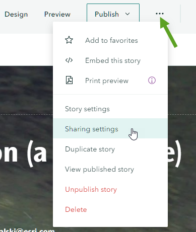

To share a story properly into a group used on your Home, edit the story then open options (...) and click sharing settings:

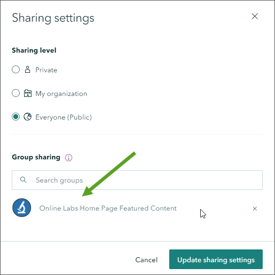

Then share the story into the group used on your home page.
If a user is prompted to authenticate when you share the link, that indicates the story is not shared publicly and only shared within your organization. I'm not sure how you are getting the link (am suspecting you are grabbing it via the browser URL) but for a public story the surefire way to get a link is from share, which only appears for public stories.
