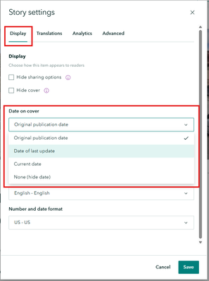

Jim, click on the three dots and then on Story Settings.
Then, click on the Display tab and drop the list down for Date on Cover. From there you can choose Date of last update to give you that date.
JimWooten
Brilliant! Thank you.
