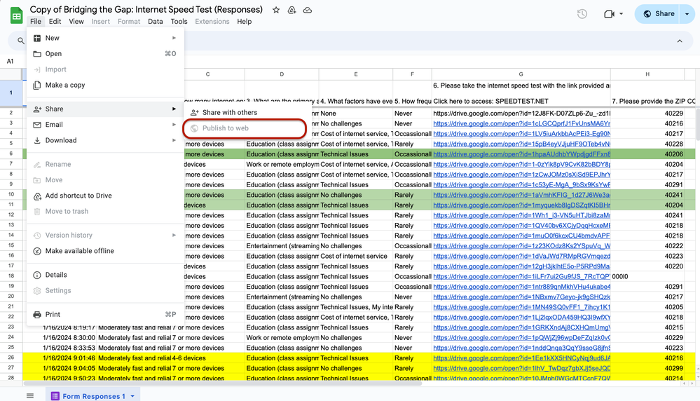

This behavior is actually due to the Google Sheets that follows right after (Copy of Bridging the Gap). Can you try removing that one table, and see if the navigation issue resolves itself?
The correct way to format and add this URL would be to utilize the URL from the File>Share>Publish to web button. When adding that URL, the story should no longer jump when reaching the embedded content.
Let me know if this workaround works for you!
