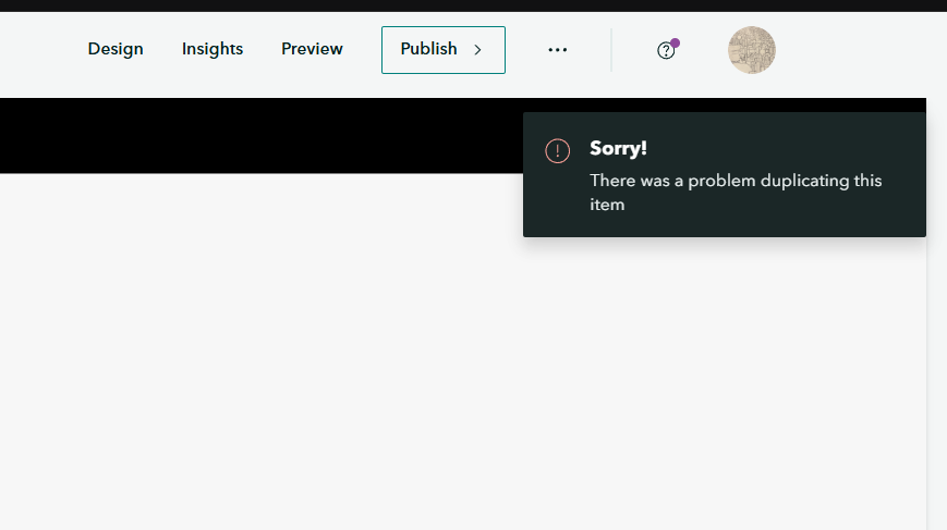

Becuase it's a student project, I tried duplicating it, and I get this message:
It still duplicates to my account, but I noticed everytime I try to edit it, it just gets stuck on Saving... and doesn't complete the Save process

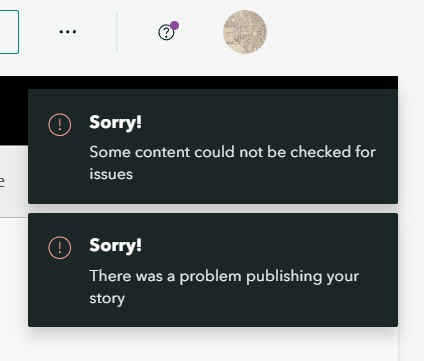

Every time I try to publish it (any visbility) I get these messages
I'm unsure what to do at this point and wonder if anyone has suggestions! Because it's stuck, I can publish it to share for others to view here. I have admin permissions so it's not a permissions issue - it happens in multiple browsers and multiple computers of various OS.
