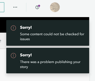

Every time I try to publish it (any visbility) I get these messages
I'm unsure what to do at this point and wonder if anyone has suggestions! Because it's stuck, I can publish it to share for others to view here. I have admin permissions so it's not a permissions issue - it happens in multiple browsers and multiple computers of various OS.

Quick update - I created a blank StoryMap, and then copy-pasted all of the text content to the new StoryMap, and reuploaded the same pictures and Web Map.
It saves and published successfully! So recreating the project from scratch fixed it. It's a really mystery on why the only other won't save with the same exact content, but the new version works.
