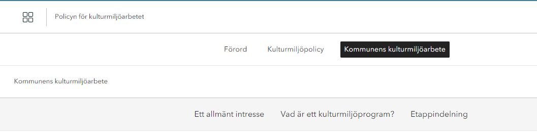

We have noticed that the story maps title that we had previously hidden in our applications is now shown everywhere. We embed our story maps to experience builder where we have our own menus and we do not want to see the story maps title as well. We noticed this change today and we suppose that it is due to the recent updates.
In the case of collections the problem exists even within the story map application. The picture below shows how the navigations is shown today. The second line on the picture below is abundant and it is the story maps title that shouldn't be there.

@andreoudi - Thanks for reporting this. We can reproduce the issue and are looking into it. I'll post a note here when we have more information.

When I Used the option ?heading=false then the title is not visible anymore, but then  I have to change all the embedded storymaps manually. It looks like that default value is change for the heading is set to true.
andreoudi
I have also tested this. It works for stories but as you mention you have to change the embedded stories manually.  This solution does not work for collections though.

We've tracked down the issue and plan to address this in our next update on Nov 21.
I'm sorry for the impact this has had on your collections.
