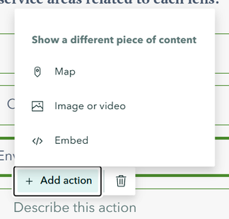

Hi Owen! For some reason I'm not seeing an Update current map appearance > Edit map view option when trying to add a new map action (within a sidecar):
OwenGeo
Esri Notable Contributor
@LindsayWithers1 - That option appears only after you add a map to the media panel.
